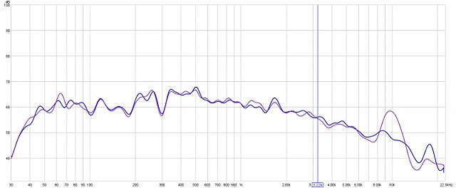

Base Panel Test Setup
Purple Glue vs. Green Tape Exciters to Panel
Teal Base Panel vs Magenta Exciters w/ Spiders

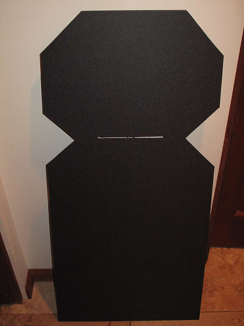

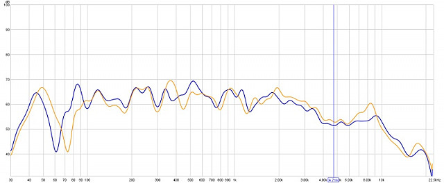

Oblong Test Panel  (dimensions top 18"W, base 30"W, height 48", note the center mounted exciter)
Purple Base vs Oblong narrow side down

Well from those graphs you can see the effect of the spine/frame and edge retention helps to reduce the sinusoidal response in the bass and high frequencies.  Clearly these exciters have major roll-off in the higher frequencies, and I want to experiment with testing through a receiver with high frequency compensation to see how much I can bring up the top end.
The Oblong panel was the best sounding of the various free-standing panels I tested, with better bass response when used upside-down, it also had new exciters on it vs. the base panel that had been run at least 15 hours up until the point of testing.  So possibly it will loosen up and become even more lively.  Surprisingly it did not suffer from the center mounted exciter like the 5 exciter panel tested.  As you can see from the layout marks I plan to test a staggered 5 exciter layout, though I wanted to baseline test it with 4 exciters so it had equivalent output of the other panels.

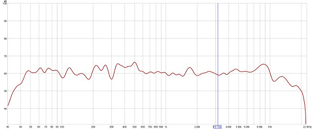

I dug out an old Technics 7 band EQ when I got home this evening and did a quick tweek, here is what I got after a little fiddling.
Panel with Foam wedges 2 per side at 1/3 and 2/3 height
Same EQ setting with varying foam wedge placement, Black = LR x 2 1/3's, Blue = LRB middle spacing, Red = LR only mid spacing

After that I started pairing down the panel, taking more and more off the length and width.   Ultimately I tapered the sides and then cut a relief slot and side wedges to try and isolate the upper exciter to see if it would promote HF transmission, I also tried ribbing out from around the uppermost exciter toward the edges, still no breakthrough.
The one thing I was able to test before I lopped the corners off the oblong panel was my theory of applying EQ to a panel which had a better base response. The results seemed to back that up with a flatter HF response once boosted with EQ.  I went ahead and ordered a Behringer DCX2496,  I had been wanting to experiment with one for awhile and this project finally pushed me to buy.  Though I am wondering if the PEQ may be a better option since it is geared as an EQ only, and maye have more filter options.  The HF rolloff is pretty drastic so a better transmitting material would be ideal, but in the meantime EQ is my best bet even with heavy dB boosts.  I was thinking about a small square or rectangular panel of aluminum either above the main panel or suspended in a cutout in the center of the large NXT panel would maybe compensate for the highs, that is all of course if the aluminum measures appreciably better.
Lastly, while I don't have an overlayed graph ready (you can look back at my previous EQ post), with Panel 1 in the frame with optimized foam wedge placement actually ended up worse than the Oblong panel with varying offset exciters, that is before I rounded the corners off.  I am tempted to cut my full scale panels in oblong configuration considering I could square them up later on.  Overall the best base panel performance before any mods.

Oblong Base Panel (before rounding) with EQ
