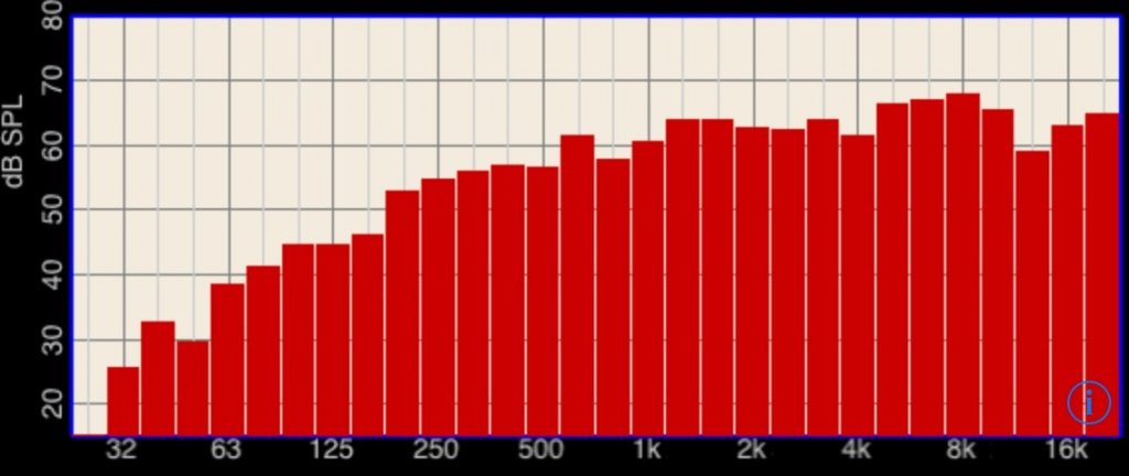

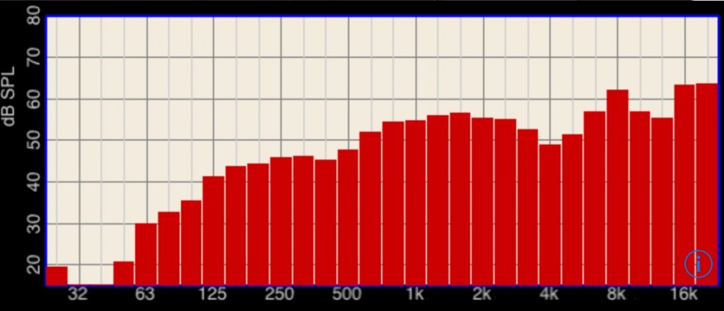

What happened here???
Comparing the freq. resp. of the DAEX58FP to the better sounding DAEX25FHE-4 you can see that the DAEX58FP does have more extended bass response which may be responsible for some of its boomy|sluggish performance???
DAEX58FP - 1. close miced'   2. from the listening position
DAEX25FHE-4 - 1. close miced'   2. from the listening position
note : Ignore the output levels as they did not receive the same signal level.
Look at the differences between the 2 DAEX25FHE-4 responses.  There doesn't seem to bee as much difference between the 2 measurements.  Then compare the DAEX58FP measurements... the close miced' freq. res. shows noticeably more bass output?
I wonder if the increase in bass response is panel "noise"?  That may explain boomy, fuzziness when listening to the DAEX58FP... wouldn't rule that out.
Unfortunately I have already tore down the crappy sounding DAEX58FP's off the panels so no more troubleshooting and comparing can be done.  :(
Curious what would happen if I EQed the new panel response to match the DAEX58FP's???

I borrowed a mic to do some measurements as welland once I figure out how to use it correctly I will post some plots soon.
Do you have a line chart with more detail and not so much smoothing  on? I'm just learning how to measure so I'm probably the last one to ask, but I noticed on my measurements that the boards are very sensitive to where they are held, suspension points, etc. Kind of like someone said before, you can do some equalization directly on the board.
I got the smoothest LF response if I suspended the panel, which I did by holding it by hand on the top middle. I almost got just as good if I put it on cedar rings with some moongel sandwich in between  (what drummers use to dampen resonances). This removed huge swings in the plot between 20 to 80hz and also extended the top end. Do you see this as well?
Interesting that you have a peak at the 16kplus frequency, as well as the long falloff on the 25. Perhaps that will make it easier to integrate naturally with a sub??
The RTA measurements above are not accurate in the low freq. range. I posted them to show the differences between the 2 exciters on the same panel.  Overall, the low frequency output is quite good with the DAEX25FHE-4 and probably plays flat to 65-80Hz in my estimation.
These measurements are taken with my iPhone 5 with the Dayton Audio iMM-6 Calibrated Measurement Microphone.  I experience the same problems when measuring low frequencies with my open baffle bass bins so assumed that it was due to the bipolar response of the OB and these panels.
I'll play more tonight and research a little as to why I get this.   Any ideas?!?
