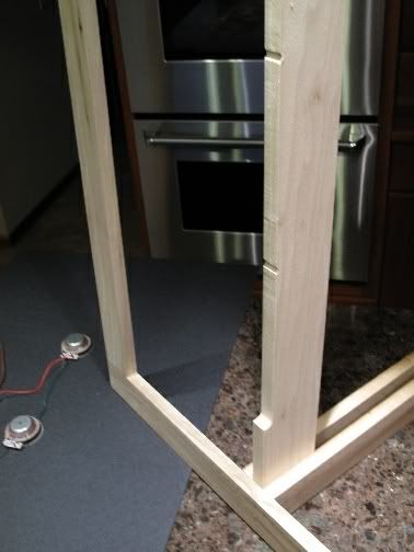

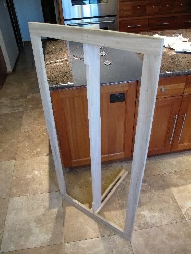

Here is the frame I shot together real quick, it has a 2 deg. back-sweep.  Before attaching the spine I routed a 17/32" relief where the exciters attach so the panel will be centered front-to-back within the frame.  Then I overlayed the whole frame over the panel and marked the centerline of each exciter, then I used a carbide burr I already had setup in a rotary tool and relieved the front of the spine so the vents on the exciters could breathe.   When I'm ready to test the panel in the frame I plan to use some hot melt potting glue, it's softer than standard hot glue and will be easier to remove the panel if necessary.

Very nice work Donka!

Looks great!   I had similar ideas on building such a frame, its nice to see someone has done it.
So, from what I see, you are planning on mounting the panel to the frame by putting the glue on the panel's edge, right (not on the panels face).
Is this the way podium does it as well?
