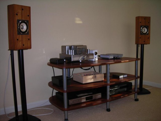

Thanks zygadr for the information. I am planning to use my Virtue Two Class D amp. I have a 130W 30V SMPS for the amp, so it should have ample power to drive a 4-8 ohm speaker system. I currently have a pair of Fostex FX120 drivers mounted in Jordon bass reflex cabinets, and it sounds like these planar speakers have a sound quality similar to a crossover-less, single driver speaker system.
Like you I am also using a Playstation 1 that I modded myself, so I may want to ask you later about using tranformers on the output stage as you did. I saw your posts over at diyAudio about your Playstation mods and they sound interesting.
