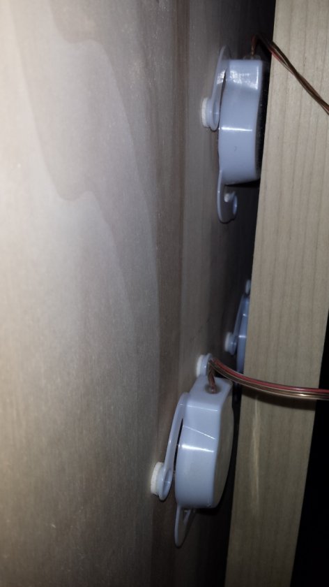

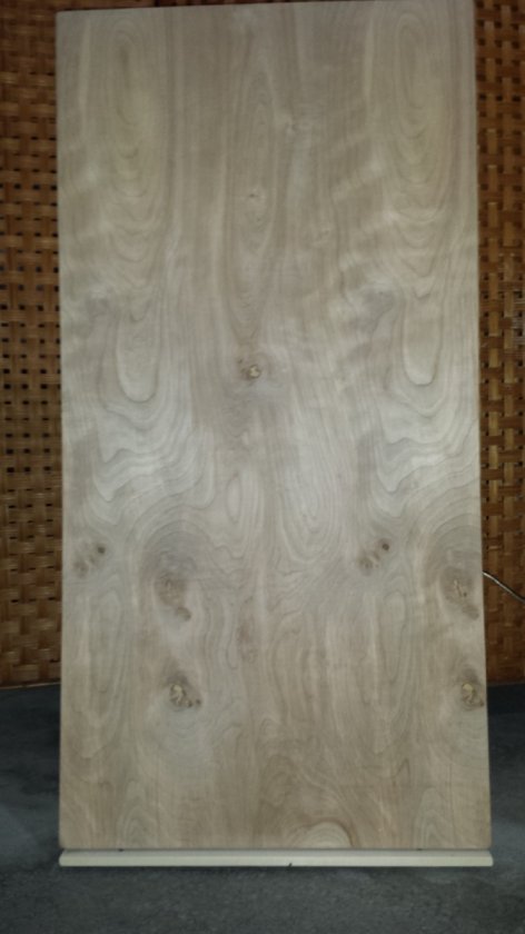

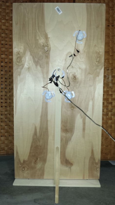

Here are some pictures on my experimental project
Back
Close-up on exciters from the side
It's hard to tell from the pic, but there is some velco between the top exciter and the stand it leans against
Front
Note that it stands on two nails

Hi Odal3.
Firstly, you MUST remove the excites from those stupid spider plastic casings as it seriously affects the performance of the exciters. The output and clarity will be noticeably superior as has been found on previous postings including my own original findings.
Now, you have discovered the obvious benefits and incredibly natural sound of thin laminated wood sheets and it's about time that we all started to focus on this material with the more ''grunty'' exciters and mounting methods/positions!!
Have you tried the ''MONACOR PLACEMENT'' of the exciters???
I myself have an irresistible urge to try 6-8 of the highest powered exciters in a vertical line configuration to enable the required output from thin, good quality plywood.
There is a dark horse sitting here somewhere..........I'm sure of it!!!! :scratch: :scratch: :o :o

Thanks for the input! Yes, I know - the white shells got to go (which I believe was one of your general recommendations a long, long time ago on this thread.) I was eager to try them out when I first got them that I just put them on as is, but then I never found a good replacement tape in my local store so they got left on as it. But once I clean-up the panels and wiring, I will definitely follow your advice and use them without it.
I read about the Monacor placements after the fact, but haven't tried it yet (but will soon). It makes sense to adjust placements after where the acoustical resonance nodes and anti-nodes are located on the board. The Monacor placements as linked to in post 1755 seems to be a great starting point, but my guess is that there exact locations will be dependent on a lot of factors such as board thickness, material, how the board is held, etc. I only had 3 exciters at hand for each panel when I started so I used my ear in the same way as I would tune my guitar. What sounded best to me is not too different from the Monacor placement. The forth exciter was an afterthought when the next shipment came, and I'm not sure how much it really added. It will go back into the middle again.

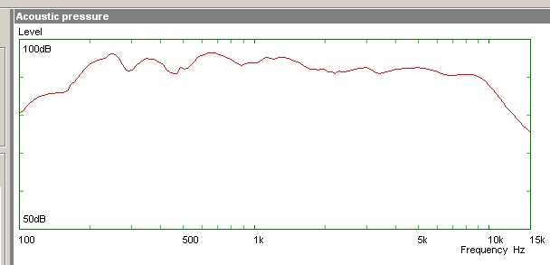

about a week trying to simulate my next single СС panels. I've managed to get all of the CC mechanical parameters needed and successfully fed it to the NXT Designer. It seems the results are more than truthful - there is NO highs....  :lol: Just check out the pic:
The simulator's Help uncovers some interesting facts on that problem, will post it later...
Hey guys!
Yes, that response curve looks very much like an average 8 inch twin cone driver doesn't it??? :duh: :duh:
