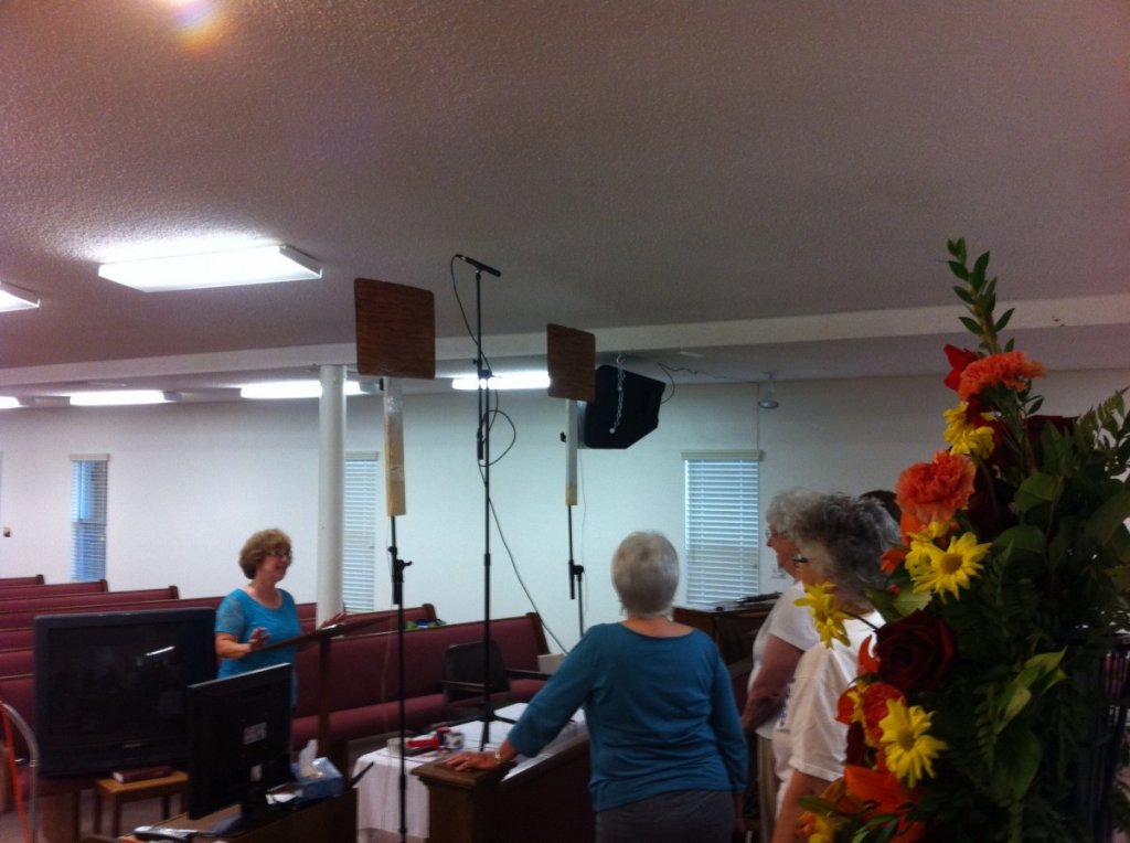

« Reply #1910 on: 25 Jul 2014, 01:42 am »
Back again...  had to build this in the meantime so I took a little time off from my speaker project!
Back on track now, and I have been progressing even during the distraction.  More photos in the gallery.  I opted to actually attach the exciters to a small circle of plexiglass, and then glue this circle to the panel (shellacked cardboard).  Adhesive is called E6000.  I painted the back of the panels white for aesthetics, since this (the back) will be seen from the room.  The front (facing the performers) I will do in a faux woodgrain of shellac.  Oh, and I scraped the spray paint from the contact area prior to gluing.  All in all, I am pleased with the sound, and believe it will serve it's purpose quite well.  I may add a subwoofer though... it sounds a little "thin".  I'll see what the choir director (my sister) thinks.
« Last Edit: 25 Jul 2014, 09:49 am by FrankCA »

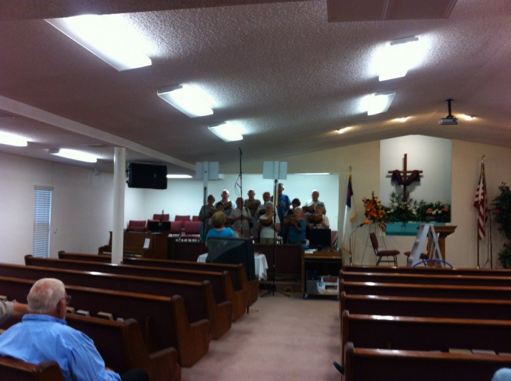

I now have finished both panels, mocked up mounting in my "studio", hooked up the amp I will actually be using to drive them, ran a bunch of different music genera through them, and they are going to be GREAT!!!   They sound really stunning on everything except when there is an overabundance of bass.  Small panels seem to lose their way when the lows go beyond a certain point at high volume.  Not a problem for my application though.  At the levels they will be played, they are far more than adequate.  Epic win!  WOO HOO!  This is premature, and I will repeat it at the end of the project, but THANKS TO ALL WHO CONTRIBUTED TO THIS THREAD!  Your hours of experimentation saved me from a lot of dead ends I might have reached had I never happened on this from a Google search.  The only snags I hit was in the making of the panels.  It took some time to understand shellac, which I have never worked with before.  Check out the gallery!
FrankCA
Re: NXT.......rubbish??....THINK AGAIN!
« Reply #1914 on: 5 Aug 2014, 06:20 am »
New photos of the mock up installation for testing.  Our choir does not generally convene in the summer (we are a tourist area, and we are all too busy!), so the director rounded up all the singers that were around.  Hooking this up was taxing due to a lack of adapters.  The sound guy brought speaker cords instead of shielded lines, so we had to cob together a single line running from the mains bus rather than the actual monitor bus (I know this won't make sense to everyone...).  The upshot is that we had one output source splitting to drive two inputs instead of two separate lines from two separate outputs.  We should pick up a lot more gain and better impedance matching when we get the proper cabling.  ANYWAY... the sound was a huge improvement over the system that was used in the past (wedge floor monitors).  After we tested the choir, we used it with a solo clarinet and it sounded amazing!  The player (like myself) is an ear player, and could never hear himself well due to the proximity of the piano.  He said it was great sound, and you could tell it during the performance because he played with far more confidence than usual.  SCORE!  I think this will be an awesome solution to our sound problems.  Thank God!
The final mounting will be slightly closer to the ceiling, and will mount from above like a pendulum.  Also, no telling how much sound was lost from the way they were mounted for the test... a good, solid mount will transfer a lot more energy to the panels rather than vibrating that whole rickety stand!  Frank
