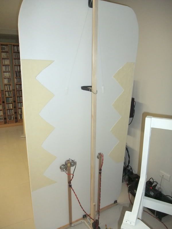

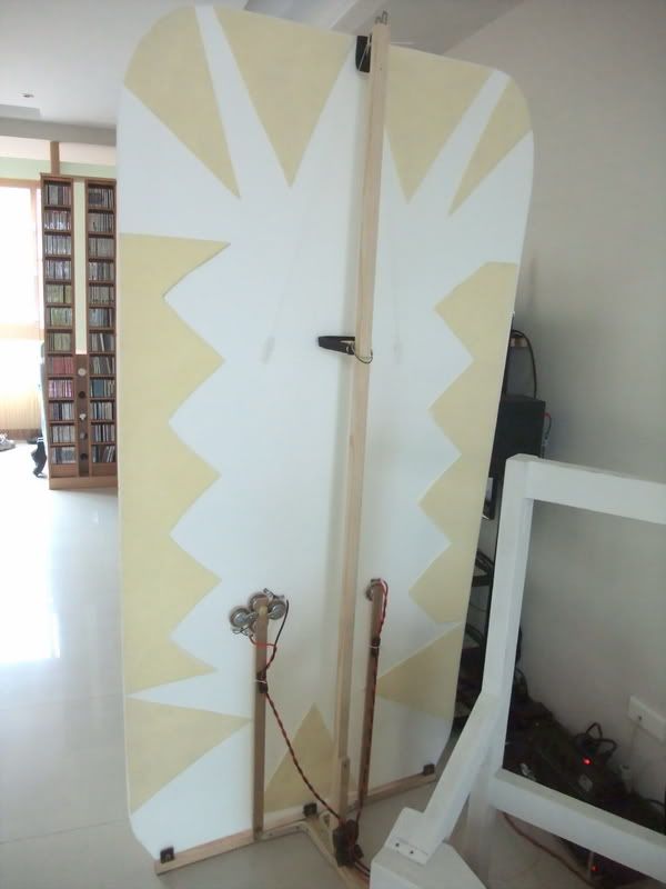

Re: NXT.......rubbish??....THINK AGAIN!
« Reply #1367 on: 28 Apr 2011, 12:29 am »
....  Were you thinking along those lines when you did this?  ....
Yes  :green:
Well, sort of, at least. Talking about 'bending wave', Manger might be one of the biggest name. It also has such damping around the outer edge.  :wink:
I'm thinking of adding more, or even trying EnABL...
I made the conclusion too early in the previous post. After more listening, I feel the notch at 6.3kHz is still needed, with less depth, at least for most records at this stage. That means the resonances are not thoroughly cleaned. More damping is needed.
Nevertheless, the overall effect of the fabric is still positive. The sound is even more natural, with more smooth details in the critical band - higher mid to lower treble. Or, the slightly less rear firing energy (or in different behaviors) helps on reduce the reflection, and this may also improve the clarity.
I've never done these on ordinary drivers. (diluted PVA glue is the only treatment I've tried on my cone drivers... ) Now with such panels, I think these 'edge damping' techniques make more sense.

Adding some more:
 :green:
« Last Edit: 23 Aug 2011, 03:20 am by CLS »

CLS
« Reply #1370 on: 3 May 2011, 03:49 am »
Hi zygadr,
The arrangement of the excitors on my panel followed the 1/3 suggestion by Pol. (and only the single one is singing fullrange; the 4-unit group works under, uh... several hundred Hz, I don't remember the number... )
I'll try other styles of distributions, once I figure out the securing means.... Appearently it'll happen on another set of panels since this pair can not take the abuses of repeated trials. Meantime, I guess I'll add the ribs/frames into the whole thing...
About the newly added fabric, I think they do good things to me. By them I really eliminated all high Q notch filters in my DEQ. Now there're only minor EQ's (-3dB ~ +1.5dB) at some areas for the FR shaping. It's always good to remove those deep notches in DEQ, by which it means I loose the revolution (less bit depth). Generally it'd be better if the problems were taken care of physically (or acoustically).
After the 2nd round of fabric damping, the sound is now even smoother and singing with more natural details. I love it. (so I'm enjoying the result very much, and somewhat lazy for the next trial...  :oops:  )
Other than edge damping, I think the change (attenuation) on the rear radiation contributes to the overall sound, too. Slightly less rear wall reflections make the sound clearer and the space information is more real to me.

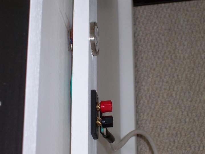

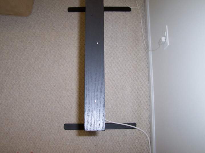

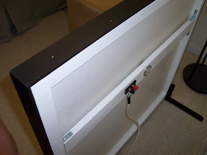

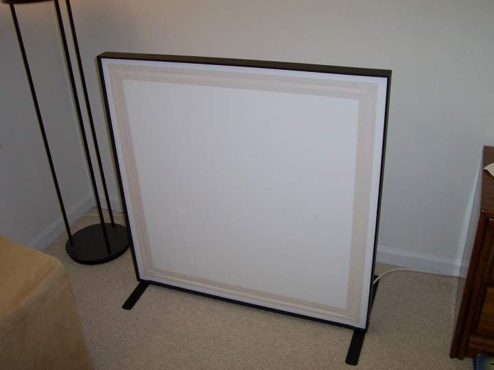

Here's the pics I promised months ago.
I didn't include a picture of the other speaker. That one has the warping on the 2 corners that really angered me. You really have to look to see it, but I am still pissed regardless. It's about half an inch out of whack on the two diagonal corners.
pol_bct
« Reply #1373 on: 13 Jun 2011, 05:37 pm »
nice design ! which transducer is that?
how is done the "suspension"
POL
zygadr
  • Posts: 491
« Reply #1374 on: 15 Jun 2011, 02:57 am »
Looks like the more expensive, flange mounted ''high shove'' version...........used on the Podiums.
irishpatrick33
« Reply #1375 on: 22 Jun 2011, 06:52 pm »
Correct. There is a single driver on each panel that is the Dayton Audio DAEXSFH Steered Flux High Shove Exciter 25mm. It's mounted on the top third, even though the pictures deceive a bit.
The suspension and design is ziggie's suggestion: gaffer tape with about a 1/2" gap between the panel and frame.
The connector is some partsexpress cheapy.
The rest of the frame is wood and hardware you can find anywhere.
However, the feet cost a bit of money. They are Magnepan replacement feet. I think I paid $100 for them.

CLS
« Reply #1379 on: 29 Jun 2011, 04:32 am »
To framed, or not to framed, that is a question.
That's a beautiful build for sure :green:  However, I thought of a tambourine when looking at the pictures.
There'd be some tension on the 'surrounding', am I right? If so, it'd become a resonant system -- there'd be an obvious low end fs (with an impedance peak), like normal speakers. I'm not saying it's bad (or good). This might probably contribute to the bass response, I guess.
On the contrary, a freestanding (frameless) panel has a fs too low to affect the audio band.
What's their major differences in performance? I've only built the frameless ones. So the inputs from you guys with more experiences will be much appreciated  :green:
