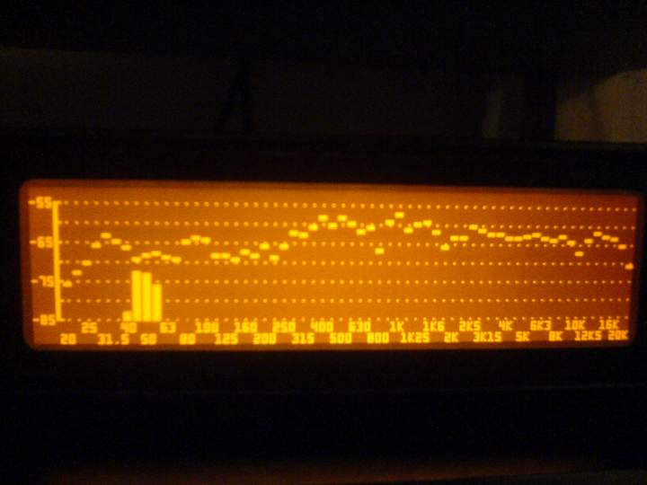

My wife popped out for a short while, so I decided to try and get some measurements of the 2x4 panel with 2 exciter hanging off the back.
I had to set everything up  in the front room as fast as possible.
It was very rushed but I hope it gives an idea of what is going on ,on the panel .
The mic cable only stretches three or so Ft into the room so I had to move the panel  towards the door in the corner of the room,not the best place , but I think it gives a good idea of on axis and off axis response.
The panel was 130cms from the mic  and when turned sideways 100cms from the edge of the panel.
The first pic is the response from the front  in that part of the room(peak hold).
The second is the same peak hold front responce but with the real time side response below (both averaged,because the dogs were going made waiting for mum to come home!).
Plus I was having to run into the music room to take the pics from the deq  before the 30 seconds of pink noise stopped and another test tone started and ruined everything !
It all ended very quickly when my wife came in and said (turn off that horrible noise!)
Those are 5 db segments on the deq and you can see the HF shelf above 10k when measured from the side.
You can also see the 100 Hz or so suck-out, which changes frome short and deep to shallow and long from 100HZ to say 300HZ, depending on room positioning and room.(big problem!).
I am very impressed with the full range ability of the panel but it is very room dependant between 100HZ to 300HZ ,this can make the panel sound thin in the lower midrange .
This is why I have talked about filling in with a 15inch driver or xover at say 200HZ to save the panel from room problems.(that’s if room treatment doesn’t work).
Sorry if this is a bit rag-tag but I hope it helps.

oops this should be the second pic!
get it right :duh:
