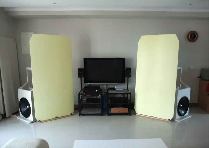

in your pics you seem to have mounted  all of your exciters in the bottom third of your panel .
For the four exciters to drive into LF should they not be mounted in the center or in a line down the middle of the panel.
the panel also looks like foamboard :nono:
that is a very good looking horn setup you have ,people are going to think you are as mad as the rest of us on this circle.

Hi sedge,
My exciters are not in the center. Both groups are at the 1/3 postions (horizontally). They are placed in the lower third because it's easier for implement my idea of 'up-side-down pendulum' supporting method, and it looks more stable in my minimal frame.
Luckily (and to my surprise), the height of image is irrelevant to the postion of exciters. I even heard some treble appearing very high, approaching the top of the panel, just amazing.
Yes, the panel is some kind of PS foam. I'm looking for high efficiency so I tried it. 2 major annoying resonant peaks in the current setup: the nasty one is @ 6.3kHz with > 15dB higher than average (probably the same sharp squeak when it's rubbed), the other is broad and mild around 2.5kH, 2~3dB hump with a sharper 6~7dB peak at the center. Both are taken care of by DEQ2496, for now.
I'm thinking of panel damping in the next step, both "EnABL" and "Manboni" are in mind, will surely try them in the next step. (uh~  there're so many things to do in the 'next' step...)
As to "you are as mad as the rest of us on this circle", I take that as a compliment, thank you  :green:  (I'm surely crazy, I know that. When spotting the first complete panel on its frame, my wife said to me, what's that? are you going to build a sailboat in the living room?  :lol: )

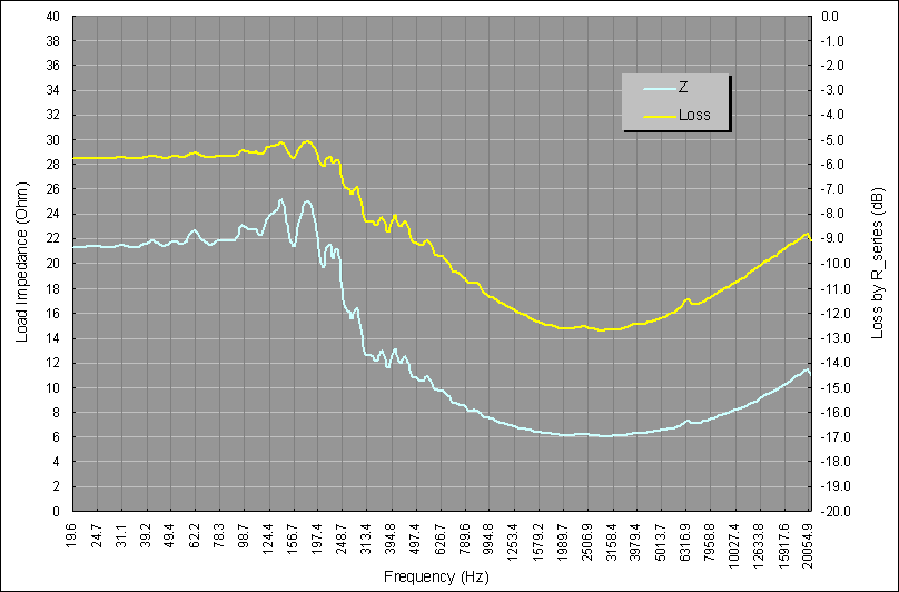

But I guess you would have missed one point in my previous post - my chip amp is very unusual with a 20 Ohm output impedance. It's setup by a mixed voltage and current feedback method brought up by Mr. Rod Elliott here: http://sound.westhost.com/project56.htm
And in the last page (reply # 1279) I posted the impedance plot of the trial system, with all 5 excitors wired in series with 4 of them bypassed by a cap (that can be seen as one half of a 'normal' series xover). Because of the bypass cap, the group of 4 is unseen (shorted) in the higher range, thus a clear trend of high impedance in the bass and low impedance in the mid and high frequencies. (plateau under 200Hz, broad valley center around 2.5kHz)
The high impedance drive interacts closely with load impedance, thus an output curve almost tracking the impedance curve:
With 20 Ohm output impedance and the series connection of the exciters, effectively I got a 7.5dB of shelfing filter built-in between amp and speaker. Unforturnately this is still not enough. I need another 15~18dB of shelfing in upstream DEQ to make it flat down to 40Hz. That's why later I turned to active setup for more boost and freer adjustment.
Interestingly it's the first time I feel passive version is better to my ear - smoother and more coherent. So I'll probably explore it more...

Effort vs money vs performace.... hmmm
So far so good here. I spent US$100 for excitors (10 pairs, that's their min. order), and $40 or so for panels (2 pairs). I've used one half of them up to now.
For the performance they give, it's the greatest c/p project I've ever had. No regret for dismantling my old horn system. Crazy? maybe  :lol:
Along the experiements, I thought I'd better release the LF load on the flimsy panels and poor little drivers. So I added cone woofers for bass augmentation - my old 18" pro woofer on OB.
I kept the panel running fullrange, but not anymore in the stress of additional LF boost. The OB (dipole) cone woofers are arranged so that they cancel a portion of LF produced by the panel at the rear side (negative lobe of the dipole bass meets bipole NXT panel).
At first it seemed not so clearly cancelled. Then I tried reversing the polarity of OB sub -- by contrast, the constructive interference is very obvious -- a big boomy bass lobe is formed at the center. Switched them back, then the bass sounds go back to both sides, as I walk around them. The destructive/constructive interferences between them are not clean-cut, but clearly audible. I guess this also reveals the 'fact' that NXT panel is radiating mostly bipole (same polarity at both sides), and indeed very ramdom (can't be cancelled out very cleanly).
Two major goals for this: less LF trapped between panels and wall, and keeping the bass sounds appear at far left and far right. After some tunings, they perform very good now. Excellent overall coherence (you all know), plus very strong and tuneful bass.
As you might get a hint by my posts, I have zero "loyalty" to any specific technology. I like anything that works and take their best part(s). (and hopefully I can blend them well...)
The journey goes on...

I am a bit concerned about what the panel material is after your description of it's properties.
It may well be a thin EPS .....who knows?............however if it feels very soft to the touch, it's most likely a different form of foam that may be detrimental to the sound.......bass and most likely the highs. :scratch:
Having not heard your speakers, I probably shouldn't be commenting any further other than to say that splitting the sound to subs etc. is not what this speaker is all about........not to me at least.
Corrugated cardboard is back in my home at the moment.
It's uncoated as all attempts to stop it from warping have failed..............sorry if I have given you false hope here as the initial experiments were with small peices, not large panels.

The fixture of my panel is built as minimal as can be. The original thought is to  make its vibrations as free as possible. Now I realize some control (damping) is needed...

Hmmm... I'm not quite sure about that. Maybe my panels are not big enough (!!). When my wife is standing in front of one panel, some sounds are indeed blocked. It's audible, clearly enough.
Two things I should add:
1) She's not fat at all  :lol:
2) The blocking effect is indeed much less than other type of speakers, especially those smaller ones. More sounds are travelling through, no matter how.
BTW, I got another special feeling, about its natural presentation. My kitchen is open to living room, in a single space as a whole. When I'm doing the dishes (yes, that's my job :oops:), with the water running, I still can hear pretty good details of the sound.
It's odd. The sound of the tap water is quite a loud broad band noise and can usually cover a lot of other sounds. But not on DML panels ! (?)
Also, the sounds from these DML panels seem more immune to other type of environmental noises. The music is just flowing through. It's not the higher loudness fighting against and suppressing the noises, it just becomes one of the sounds, naturally. Of course there'd be inevitable some loss in the most delicate small details, but generally the playing music stays listenable to a much greater extent compared to other type of speakers.
This didn't happen in my previous speakers.
Is it because of the big radiating area?
