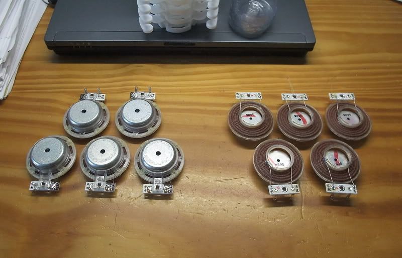

10 stripped excitors (the cheapo):

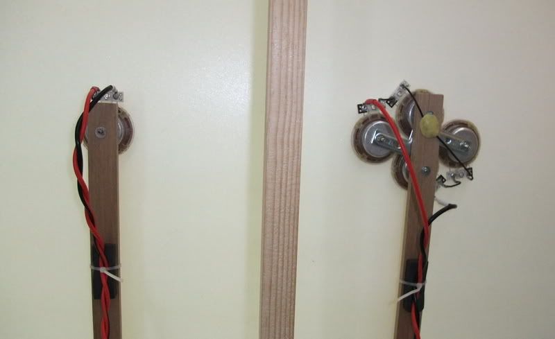

I took Pol's advice, placing the excitors on 1/3 positions, 2 groups of excitors in horinzontal alignment:
The excitors are supported by 2 thin sticks. It's like a cantilever, or upside down pendulum. Without panel, the 'resonant' frequency of the one with single excitor is about 2Hz, and the one with 4-unit group is well under 1Hz. Should be far enough from any resonances of the panel.
I'm hoping such device can support the weight of excitors without interference with for-aft movement.
Close-up:

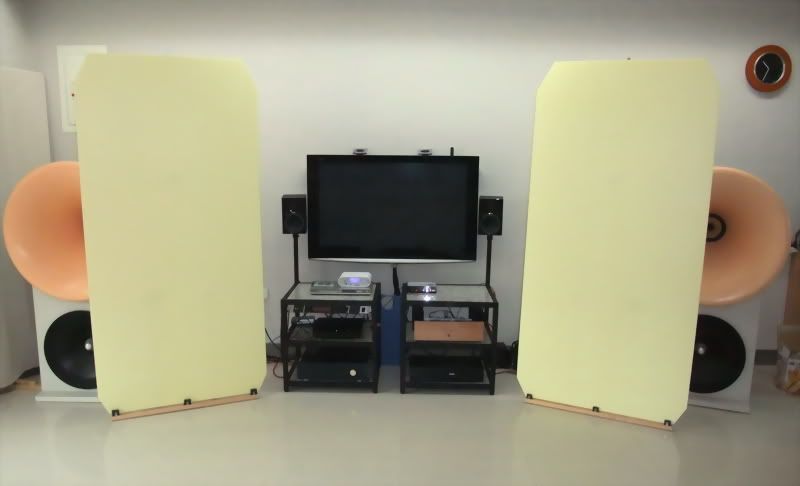

The panel is some kind of PS foam, I'm not sure it's extruded or expanded. I'm lost in all those material names you guys mentioned. The material of my panel is usually seen as the base of various posters, or used as wings/bodies of those very light model planes...
It's 182 x 91 cm per panel, 5mm thick, very light and soft and can barely stand up straight by itself. And it's slightly curvy on both ends, not very flat. The support is a minimal build, and the upper portion of the panel is suspended by a thin cotton string. A strip of foam is bent as a loop of 'spring', supporting at the upper 1/3 to maintain the fore-aft position.
The overall looks of the system:
Larger toe-in:
Already long, more later....

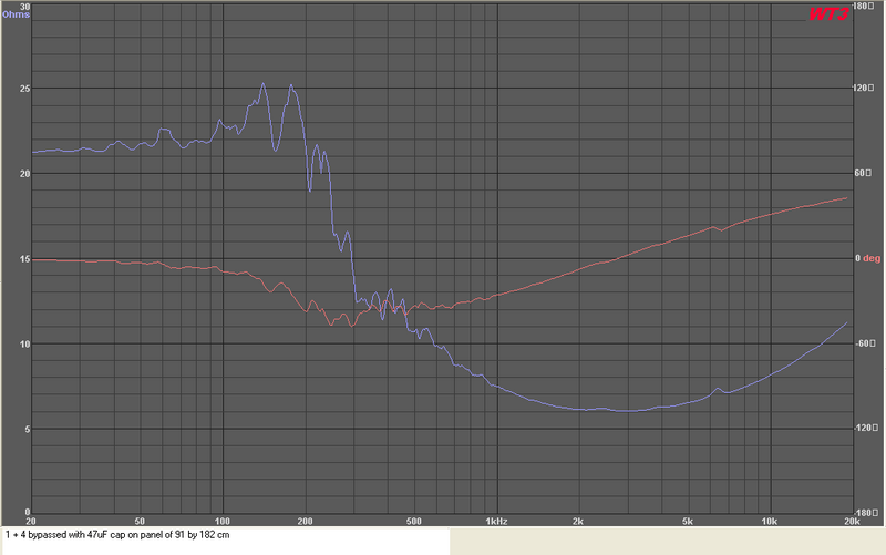

I don't know how you guys got satisfied bass from these little excitors. Up to now I've tried 3 panels - single layer small CC, double layer larger CC, 5mm PS foam big one... They all need a lot of EQ (boost) on LF to make it reasonably flat (down to about 40Hz, very little under that.... )
On the 3rd trial I made it 2 groups of excitors - 1 & 4. I wired them all in series and with a cap across the 4-unit group (so this group is bypassed when in mid-high frequencies... ) By some simple RC filter calculation (and of course some more trial and error), I took 47uF, 100uF, 160uF for the experiements.
This is the impedance plot:
As can be seen, because the LF section is bypassed in mid-high, they 'appear' only in the LF (as expected).
But I need more power feeding into the LF section (4-unit group), while high impedance is not a good load for high power with ordinary amps. Hehe... guess what !  I got my 3886-based chip amp configured as high output impedance (20 Ohm). With some current feedback, it delivers more power into the high impedance zone.
It works to some extent, but not enough. I still need some more EQ upstream (digitally, I got a DEQ2496).
Again, per Pol's advice, maybe it needs 1:9 ~ 1:10 to make a proper proportion. Or, also driven by a even higher impendance source.
OTOH, at this stage I'm not sure it's the limitation of the drivers, or the intrinsic character of the panel, or the entire setup (my minimal support system), it can play pretty loud to a level (beautifully), but above a certain point, the sound would be thickened, somewhat compressed and fuzzy... (oh, that's VERY loud indeed, enough to be painful, and bothering the neighbors... )
If the limit is not in the drivers, then it'd be a waste to use more. And the larger group might be a drawback considering its physical size on the panel - too large of the contact patch to make proper excitement... (?)
So, later I tried 2-way actively crossed at 160Hz or so. The brief impression was good, but it still needs some more fine tunings and evaluations.
