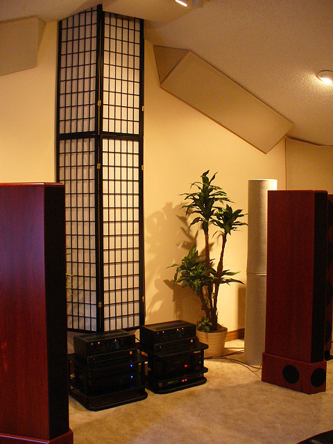

Enough materials have come in for me to get started on my project.  I have been able to complete just over 1/3 of my front wall.  But, before I did that I needed to get a few basics straightened out.
First off I checked the positions of both my low bass towers and my main speakers to achieve the best and smoothest bass response possible, low bass for the towers and mid bass for the upper range sections.  I was not worried about enhancing peaks at this point as I knew I could take care of them later.  My concern was more focused on minimizing the dips in response.  Along with changes in speaker positions came a change in my listening position as well.  My seat was moved back about 6 inches closer to the rear wall, the bass towers were moved 10 inches closer to the front wall, and the mains were brought into the room about 6 inches.
Next came the toe in adjustment done with help from a Chesky test CD for soundstage.  This was a critical step because I didn't want to loose the presentation I had before moving those speakers, and that is always a possibility.  Often to gain one thing you need to sacrifice something else.  Fortunately that was not the case here at all and I actually ended up gaining quite a bit more than I had previously.
The third step delt with the electronics and came in two parts.  First was to check and modify my crossover points and phase adjustments due to the new speaker locations and their interaction with the peaks and nulls.  I did up my crossover point of the low bass to 66 Hz and changed the slope to 18db.  The second part of this was to use the power of that modified digital crossover to notch out any peaks created by either the room or my crossover points.
With the room and equipment set up as good as I could get it, it was time to start modifying my room treatments.  But, before I did that I took benchmark readings charting my room one hertz at a time up to 125 Hz or so.

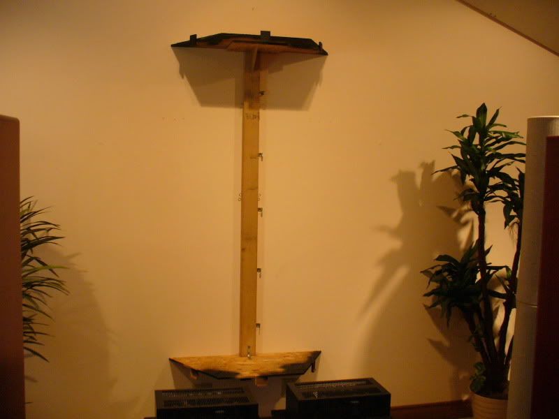

This image shows the lower foundation of my wall treatment.  It is well anchored to the wall.

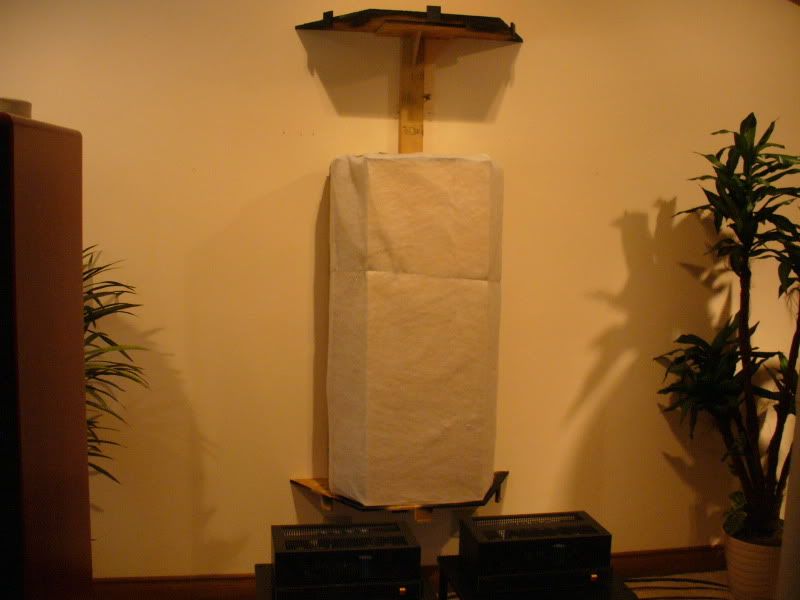

Here is about 1/3 of the treatment in place.  It consists of two layers.  The first is 6 inches of 2' x 4' 703.  On top of that creating a semi-wedge is 6 inches of 17" x 4' 703 and wrapped in a batting.  I didn't see any reason to remove it from the box and just cut the box to the shape needed.  The top was left off so it could function as a reflection point absorber as well.
This is the lower decorative cover.  It is an oriental three panel room divider screen found at Target for under $100.

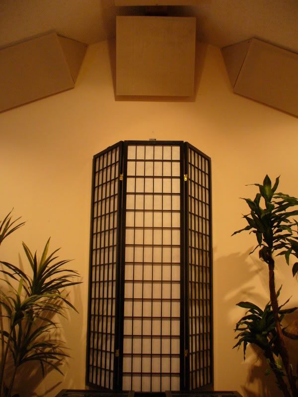

To finish the front wall treatment the 703 will continue solid up that wall to the peak and be surrounded by another screen.  I hope to get to that in another two weeks once I get back into town.

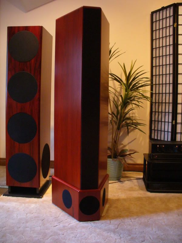

This last picture shows the new positions of the speakers.  Those small changes made a difference.  With only 1/3 of that wall treated I did take a few measurements to see if any progress was made.  The largest bass concentration is up higher on that wall and at the peak, but even so this center wall first reflection point work did start to fill in the dip at 45 Hz.  It is just a start by measurement standards, but my ears tell me that I have already made substantial gains.

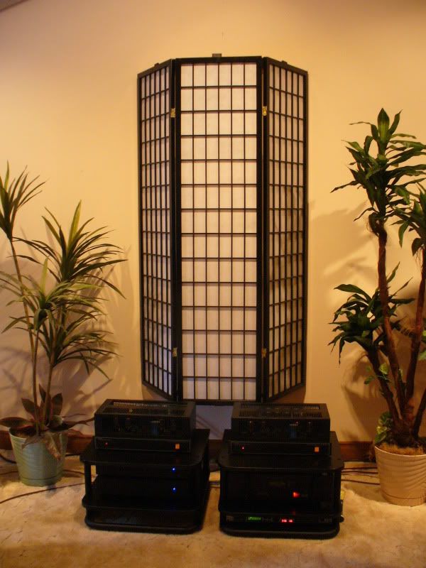

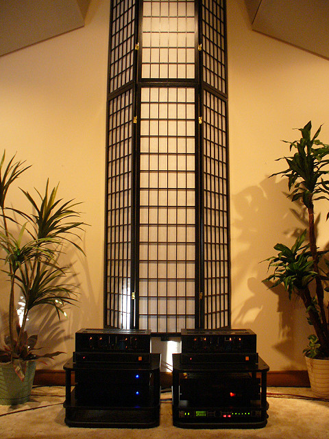

Well, I made it back home finally and was able to complete my front wall retreatment.  The entire project went together without any problems and was easy and fairly inexpensive to do.  I was only out a few hours of work, the cost of two boxes of 703 and two oriental room divider screens found at Target Online for $99 each including shipping.
Behind those screens is 12 inches of 703 running their entire length.  The width is 24 inches in the back for 6 inches of the depth, then the top six inches is 17 inches wide.
I am pleased with the new measured performance, but that really doesn't do justice to the change in what I hear.  The numbers may be small, but the overall change in character of my room is much larger that that.  The nice benefit of using broadband treatment is that while you may be targeting  specific frequency issues, many of the others you didn't even realize your were having issues with get helped as well.  I believe this is why I am hearing such a large improvement when my target dip frequency of 45 Hz was only filled in by 3 db.
I was able to measure one of those side benefits up above 100 Hz.  Between 100 and 125 Hz I had a bit of a saw-toothed pattern, up a few db, down a few db, every few hertz throughout that range.  Well, that is not there anymore.  More than likely I will be able to see this pattern repeated as I continue to chart my new room curve higher in frequency.  I never considered the small bumps and dips of plus, or minus 2-3 db as being problem areas, but I guess I was wrong.

can I compliment you on the looks of the trap?
I can? great.
They look fantastic. well done. (the system doesn't look too shabby either btw)

« Reply #39 on: 25 Aug 2009, 04:22 pm »
Yes, that looks really great.  Very creative way to place/conceal/decorate a very large trap.
