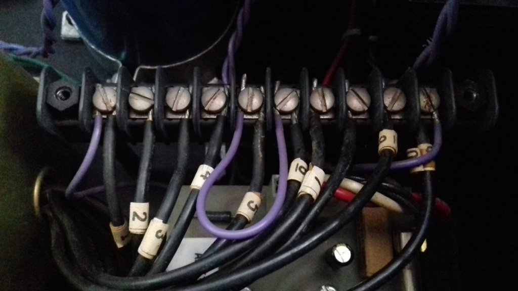

little update, I know have the info that I need but I'm a little worried about the huge filter caps.
My model seems to be adjusted for the European 230V line voltage but with a dimm bulb in series I already measure 76V across the caps that are rated at 75V. All 4 of them look like they're ready to blow (the grey rubber seals are pushed out.  Can someone confirm my configuration is correct (transformer has 10 primary wires going from 1 to 10 from left to right.

« Reply #18 on: 13 Sep 2018, 09:09 pm »
… for the Multi-Tap-International Transformer referred to as the 250 V setting:
depaj
  • Posts: 6
Re: Heads Up! Van Alstine Model One preamp and Model 2 poweramp
« Reply #19 on: 13 Sep 2018, 09:21 pm »
Thank you very much, this is very helpful !!
Weren't they cutting it very close with those 75v caps as there should actually be 75v (+/-5v) across them) ? I'm just asking because one of them on my amp just blew the safety valve and spewed its guts out after only 1 minute (volt meter showed 74v just before that). It worked perfectly with a 100w dim bulb that dropped the voltage down to 72V so I don't think there is anything else wrong with it.
