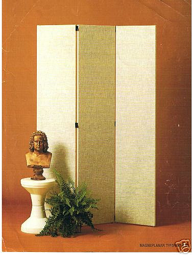

I haven't heard the ones in the picture either, but whether or not someone will want to supplement the bottom end will depend on room placement and personal taste.
But for classical music, symphony and large orchestra, even without supplementary bass Magnepans have no equal.  The smallest Magnepan has the equivalent 72 one-inch dome tweeters and 9 eight-inch woofers! Conventional speakers simply cannot convey the same realism of the bigger maggies when it comes to large scale music.
I have over 300 classical discs that I rarely listen to.  If I had maggies, that would probably change.  In fact there was only one time I was impressed listening to a recording of classical music.  That was through a 6' tall pair of maggies many years ago.
This is wierd.  Even the top of the line maggies (the 20.1) don't reach 20 Hz.  So they will always have a weakness in attempting to play symphonic music.  Personally, I think maggies are highly compromised speakers and, with the possible exception of the MMG, there are many better speakers for classical in the various product line price ranges.  With enough amplification, they can be OK for rock, where accuracy is less important.
Don't confuse the surface area of a planar-magnetic speaker with the surface area of a cone speaker.  Everything, especially the engine, is different.  This explains why you actually get more bass from a properly executed 8" cone woofer than you do from at entire MMG.

« Reply #43 on: 7 Jul 2009, 08:20 pm »
I owned the Tympany 1-Ds for 15 years
I do not know how they compare to todays Maggies, but I do know that the 1-Ds needed 2KW of bi-amped power before the bass came alive. At that power level, reproduction of drums and tympany(!) was more realistic than any speaker I've owned, or heard, before or since. I'm just sayin'.

Konut,
I heard the 1-Ds on a few occasions.  If properly set up in a big enough room, with the right amplification and enough power, they are quite the experience.  They are definitely one of the most demanding and more challenging speakers to get set up right, but when everything comes together, they are in a class all by themselves.

Konut,
This should have been the warning to me, by the dealer, before I purchased them. While I enjoyed my time with them, the ultimate challenge with them was the combination of room and placement to get anything resembling a coherent sound stage. Anything other than the exact perfect acoustic environment and room logistics, while resulting in an enthralling experience, yielded an unrealistic presentation. If one can dedicate a specific room and commit to large amps, Maggies might be a viable option for ANY genre of music..

« Reply #47 on: 9 Jul 2009, 02:35 pm »
I have owned a pair of 1-Us now for 35 years or so, powered with as much as 750 WPC, biamped.  Even properly set-up, they are at best mediocre for classical.
