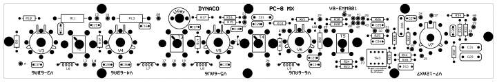

I'm making a run of new boards with some interesting additions,including DIP switches to aid in the alignment process, the option for on board pots for balance control,and those that want to do away with the volume control,and different components.

Right on Denny9167, Looks good. Have you tested them out yet? I like the idea of removing the Volume control on the FM-3.
denny9167
I've previously made a run of new boards,using basically the same layout,and they worked great,but I've just about sold all my tuners with the new boards. A gentleman on the Dynaco Forum looked over the schematic with the new additions,and told me the DIP switch wiring would work just fine.  I've also incorporated a single ground plane on PC-12 which will minimize the wiring for the pot,and lower the noise even more.
