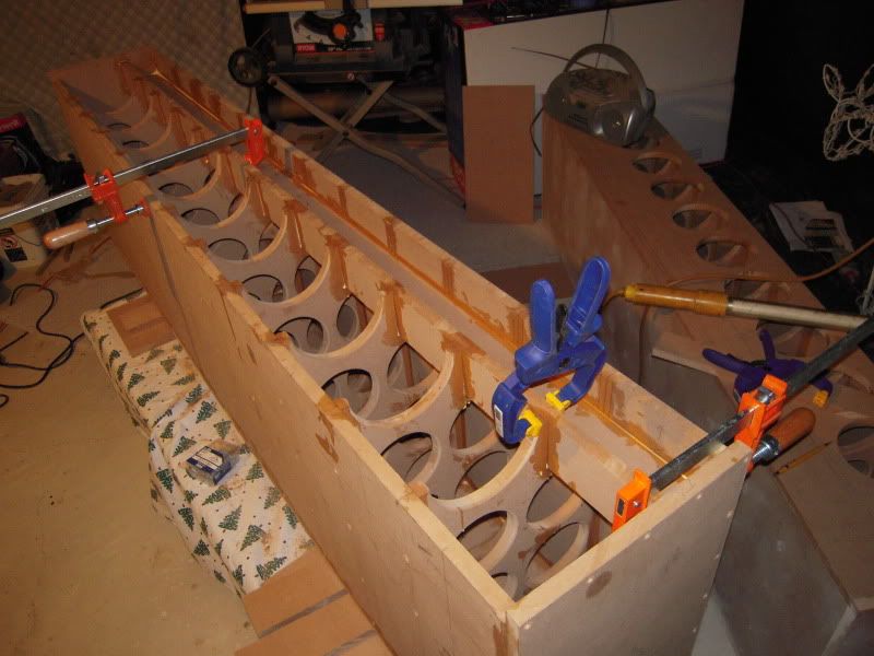

« on: 10 May 2009, 12:24 am »
Finished off the 2nd cabinet today.  Time to add all of the No Rez.  Can't wait for Danny to get the components in. IMG]http://i67.photobucket.com/albums/h308/hesster_2006/DSCN0035.jpg[/IMG]

hesster, if you haven't yet applied the veneer, I'd like to make a suggestion....
Because of the decision to use screws to assemble your enclosures, you will most likely have problems with them telegraphing through the veneer. There are a couple of reasons for this. MDF will expand and contract in thickness due to humidity, no matter what you do. Whatever filler you use to cover over the holes will not contract at the same rate, so you'll have a "dimple" or slight "crater" where the screw is.
I built a set of test enclosures years ago to evaluate fillers. We filled screw holes with 3 different wood fillers, dry wall compound, plaster of paris, dental plaster, bondo, PVA/sawdust paste. They all telegraphed the holes over time. It is permanent.
I would suggest (if you can) to pre veneer over your enclosures with as thick a veneer as possible before applying a thin paperback veneer, in order to mitigate the telegraphing that will inevitably occur.
I'd hate to see you disappointed after going through all the work you have done to build out a pair of arrays, only to have a blemished final outcome.

hesster
Re: LS9 Build
« Reply #13 on: 20 Jun 2009, 08:38 pm »
Thanks SO much for the tip!  It's hard to believe they would show through, but it sounds like you have been there.  An underlay Veneer is in order.  Glad I have not started it yet!

Yeah, I've tried just about everything imaginable. There's no escape. If you pierced the compression layer of MDF, you're pooched...fillers will telegraph. It's just a matter of time...

I never use mechanical fasteners, no. There's absolutely no need for fasteners. Have you ever tried to break an MDF box that's been glued together, apart?
You can't get around the problems with finishing, I've mentioned.
Many people assume that the density of MDF is consistent throughout it's thickness, it's not. The two surfaces are a much higher density than the core.

« Reply #18 on: 23 Jun 2009, 07:28 pm »
We use Helmitin PVA. It's just a regular yellow carpenters glue. We buy all our glues in 5 gallon pails from the same supplier. I have used the Titebond II and III for cold pressing veneers. The Titebond III is simply astounding glue.
Regular PVA dries by polymerization, while the Titebond III ( IIRC the II as well ) dries by chemical reaction (cross linking). You cannot "re-activate" them, once they're dry. It's similar to "lacquers".
We only use finishes that are cross linking (post-catalyzed). They are impervious to solvents and most acids.

« Reply #19 on: 24 Jun 2009, 03:58 am »
The 3M adhesive backed veneer available from Oakwood may be a good route to go as it is a bit thicker and may help hold back the screw sinks from showing to quickly.
 I build a pair of speakers about 8-9 years ago where I used screws and then wood filler. (I never use mechanical fastners anymore) and veneered with the 3M backed cherry from Oakwood Veneers. To this day, you will not be able to see where the screws are.
 This veeneer does limit your choices and is only available in 2' x 8' sheets but it is a great choice for beginners and should help hide those screws.
