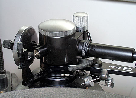

I am still not sure how sliding the cart around would change the azimuth.  You may change the orientation of the tip but you are not changing the angle of the tip.  On my Phantom arm, the azimuth adjustment tilts the cart side ways.
The screw in front of the counterweight rotates the arm clockwise or counterclockwise as you look down the the length of the arm.  Twisting the cart around horizontally wouldn't do that.
Wayner
Re: Anyone willing to help???
« Reply #54 on: 9 May 2009, 05:49 pm »
This is azimuth adjustment. Sometimes a picture tells a thousand words.
I skewed it really bad on my Rega R200 to get the point across. While I agree with JCC wholeheartedly, most of us mere mortals only have our eyesight to adjust azimuth. However, many cartridge manufacturers provide features on the cartridge body to help the installer deal with things they really can't see well. My AT440MLa has nice square surfaces in front to help align the cartridge. The sides are also square to help with azimuth alignment. We can be very confident that the stylus assembly is true to the geometry of the cartridge body.
Wayner  :D
