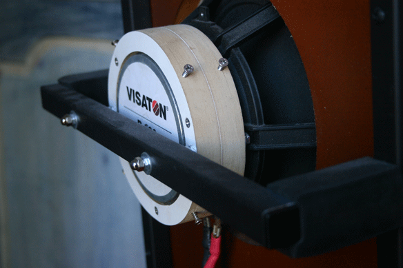

In my own case dealing with the B200, it was night and day between between magnet mount and baffle mount. The result of magnet mount was to reveal a whole layer of detail that had been  previously lost  I seem to think that the speaker projected better, as well,  which may have something to due with the fact that you hold the driver at it greatest mass, the magnet. You would really have to do it, to find out for yourself, no amount of talking about it will do. :thumb:

Mr Content
Re: Driver Mounting
« Reply #28 on: 30 Apr 2009, 05:14 am »
Yes Bob, I will dig them out and post them here. Or I can just take some new ones, as this is still my current setup.

penderaudio
Re: Driver Mounting
« Reply #30 on: 30 Apr 2009, 02:18 pm »
Mr. C
What did you use to seal the gap between the speaker and the baffle? I have seen people use foam weather striping.
Have you tried magnet mounting with a very thick sturdy baffle say 2"-3" thick? Do you think you would still see a benefit on a thicker baffle?
-Jamie-
Mr Content
Re: Driver Mounting
« Reply #31 on: 30 Apr 2009, 09:49 pm »
Hi Jamie, the baffle in the picture is 38mm thick or 1 1/2'" in your language. This was built 3 years ago. I now use a 65mm baffle. I do this because I believe that you need to have as inert baffle as you can get. I use 4 different substrates to make up the 65mm of thickness, laminated together. But I still use a steel frame behind it. Both the rubber between the rear bar and steel frame , and the rubber gasket between the driver and baffle is insertion rubber. This rubber will not squash under pressure. Hope this helps :thumb:
Mr C :D

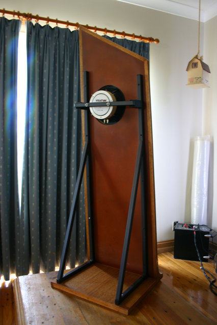

Mr Content
Re: Driver Mounting
« Reply #33 on: 1 May 2009, 05:23 am »
Mark, you will find the B200 will respond to it very well. I noticed the sound stage becoming much deeper as well. I run my speakers 1.5 m into the room, and the sound stage front to back is at least 3m, and very precise :thumb:
Mr C  aa
Mr Content
Re: Driver Mounting
« Reply #34 on: 1 May 2009, 05:26 am »
Just for anyone interested, this is what the front looks like :)
Mr C :D
