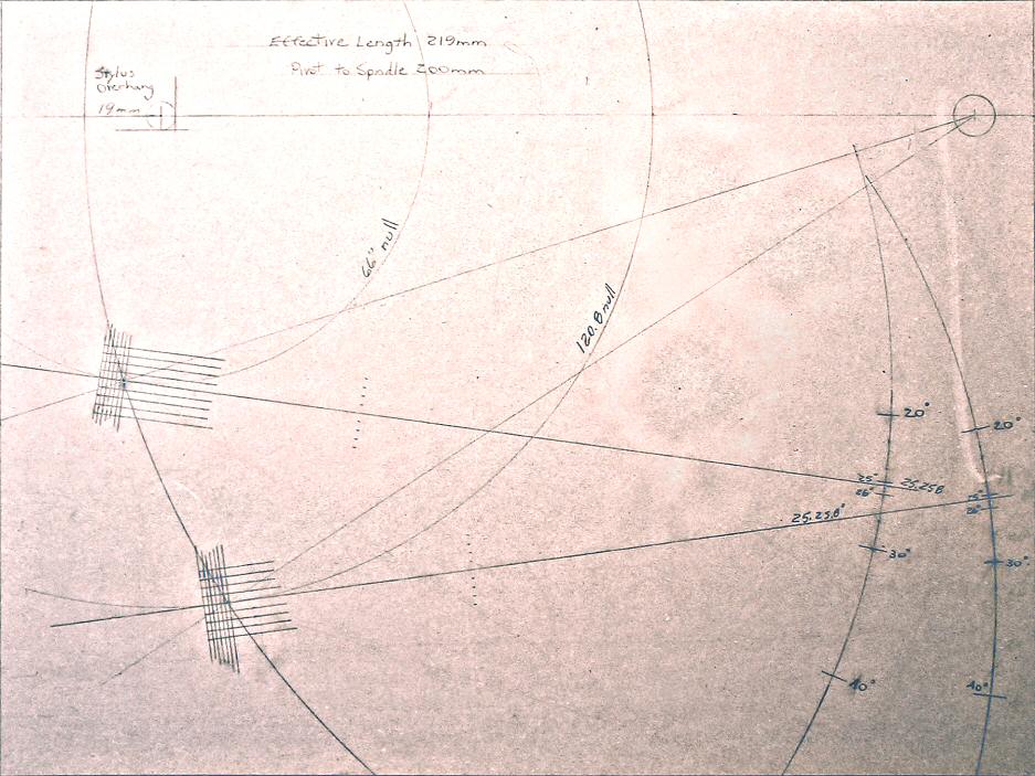

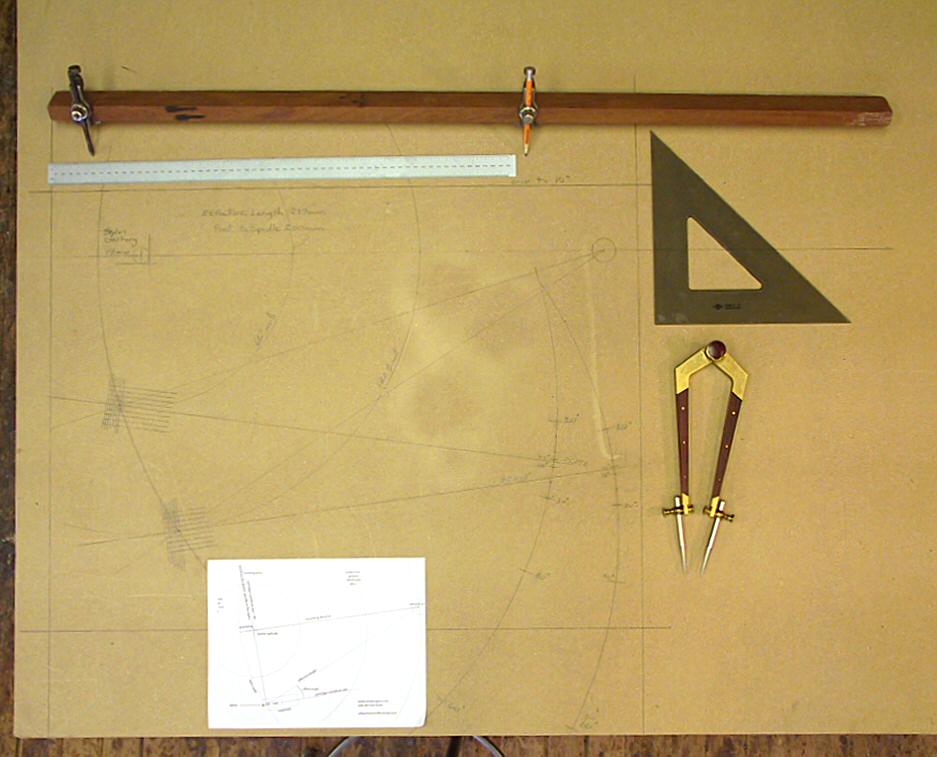

While waiting for the jig I made a custom protractor so I could compare the two systems.
I scaled up the measurements for my Harman Kardon table three times so it would be easier and more accurate to draw out using the information from the Baerwald Alignment Calculator from Enjoy the Music.
I drew a 30" x 22.5" box around the enlarged protractor and took a digital photograph, which I cropped and re-sized so it would print out at exactly 10".
I then compared Wayner's setup with the custom setup and the results were exactly the same, this means that with this easy to use tool you can be assured that your cartridge is set up optimally no matter what table and arm combination you have.

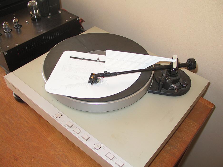

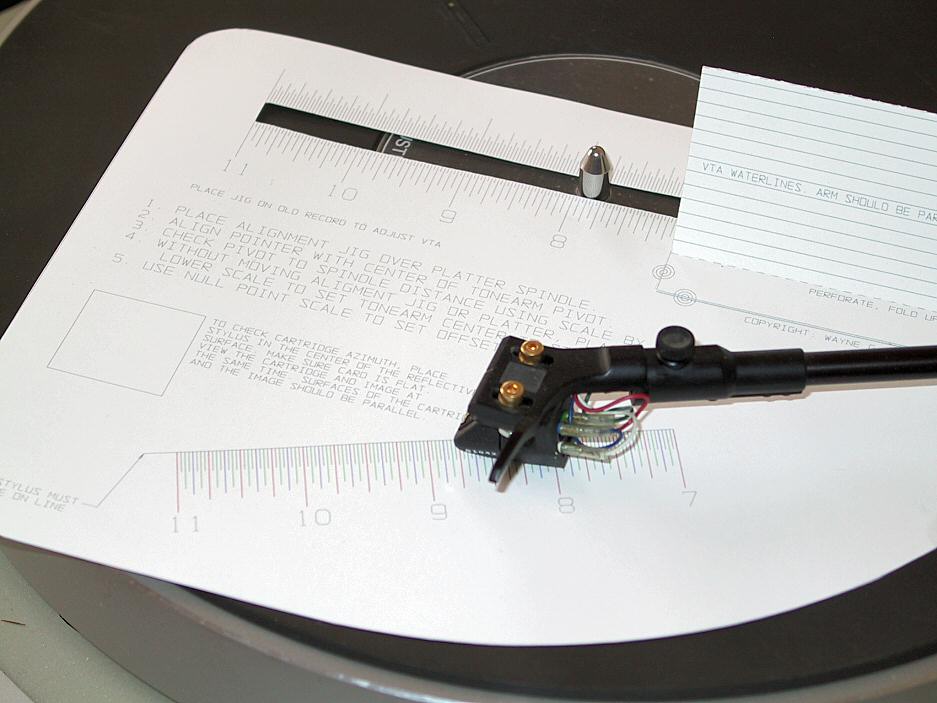

Below are a few more setup photos using the new jig:
Null points and offset angle with Wayner's jig is right on the money
I also have the Harman Kardon protractor I made available as a download. The factory got the overhang wrong, there is less distortion with a 19 mm overhang so this is the improved alignment settings. The drawing should print out at exactly 10" wide.

The changes I hear is more depth to the sound stage and an increase in low level detail transparency. High frequencies are clear without adding any surface noise. The Goldring 1042 has a Fritz Gyger line contact stylus which is very sensitive to even the slightest change, I am now getting the best sound ever after using Wayner's protractor. My home made protractor is good but the lines are not as finely drawn so I can achieve better accuracy with the universal protractor (WAT).
A suggestion for the null point scale. Placing the needle on the null hides the numbers, so if the arm drifts slightly while lowering I have to squint under the cartridge to see what line I am on. If there were numbers on both sides of the grid alignment would be easier.
The numbering system would be like a good metric ruler and the grid could be in millimeters with no break in the lines. I like the colors.

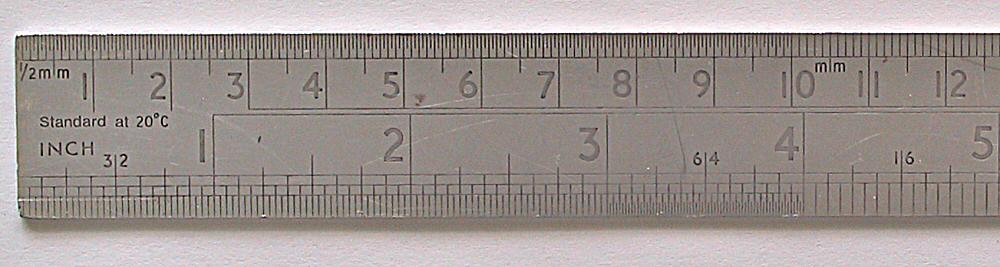

I measure a lot in my line of work so easy to read rulers are a necessity but for some reason even with the colors I find the null point scale hard to read quickly and accurately. My gold standard are Rabone Chesterman rulers that were made in England, the line layout makes sense to me.
Here is a photo of my favorite ruler:
W.
