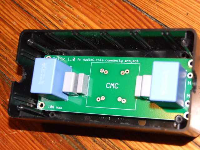

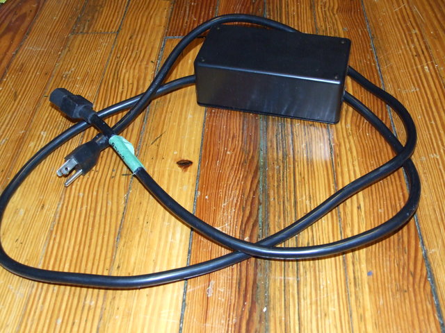

RadioShak has the 'almost perfect' size black plastic box for a Felix built on the AC Group buy PCB.
http://www.radioshack.com/product/index.jsp?productId=2062282

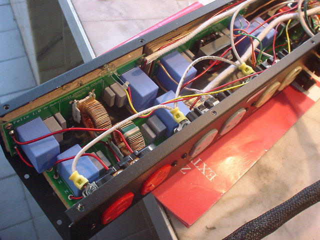

i have 3 of my Felixes like this ( all over the house)
or
unless the ones build in a former line conditioner
2 separate outlets for power amps Miller coils RC 8118
2x2 outlets for non power devices high inductance Coilcraft P3717-A

Here you go Kyrill, your Felix will look much better in the aforementioned RS box
« Last Edit: 23 Mar 2009, 09:09 pm by mjosef »
