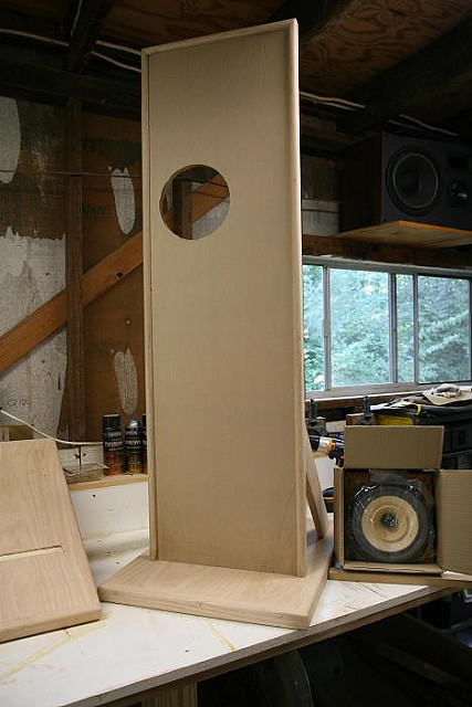

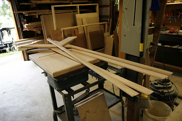

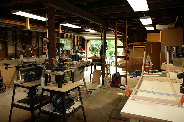

Chris (MerRev) and I have spent the last few weekends building him a pair of Lowther Open Baffles (similar to mine).
This morning I got up to the wood shop before it got too hot and made some more progress on them.
The first of the two bases nearly finished
Not too bad of a corner
The second base cut, fitted and ready for assembly
All clamped up and nowhere to go
The stanchions waiting to be assembled
Fitted and ready for gluing
...and this is what they will look like when they are completed (these are mine)
A quick pic of my wood shop

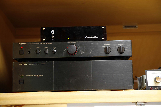

.....and of course, every shop needs tunes
...thats a Rotel RC 970BX pre, Rotel RB 981 amp, a SB2 driving the MHDT Constantine DAC and finally a pair of JBL 4410 Studio Monitors   :thumb:
With some luck we should have these finished off in a couple of weeks.

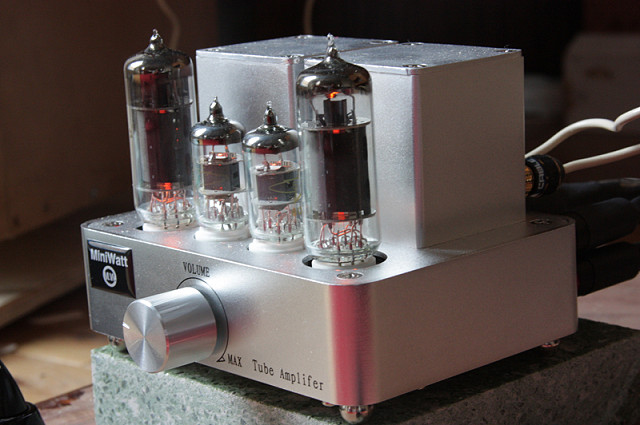

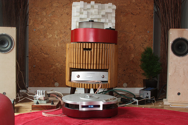

Wires
Bipolar prototypes driven with 2.5 watt amp

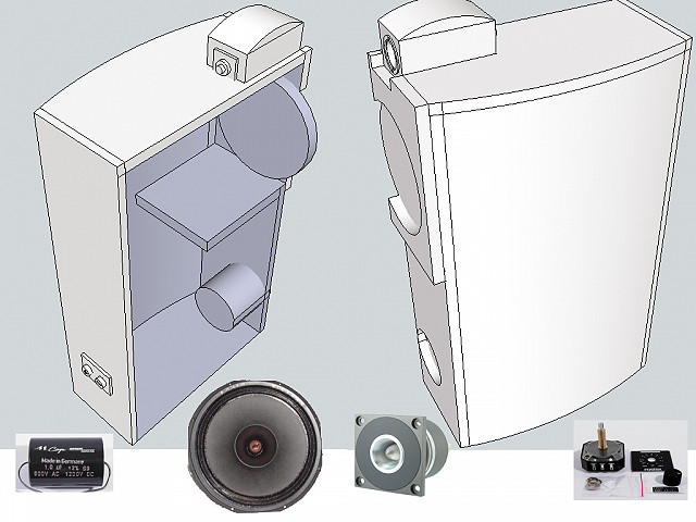

Trying to build some full range (or almost) speakers for my listening room.
Upper limitation of these 15" drivers is about 15K. Not that everyone can hear beyond that point but just because I can, super-tweeter will be implemented and crossed/cut at 7-8K (8-33K)for extra air and resolution.(attenuator at the back of the ST housing).(30Hz-33KHz)
Drivers are quite nice and presentation is definitely different then most 8" drivers I've used.
Hard to go back to smaller drivers if I must be honest.
Using this driver in OB was fun and it might be the solution for those on the budget, however. If you care about those information below 70Hz or despite using a sub in your system, OB might not float your boat. What you get tho is lock of box coloration and purity of the driver itself. I would imagine these 15 inchers in OB with quality OB subs for amazing bang for the buck system.
If not, ......... box is your only choice to get some earth shaking bass out of them.
There is some controversy about the proper box for these drivers so I decided to build what I feel is right for my taste and my ROOM.
Here is the scoop:
Cheers
Mariusz :thumb:

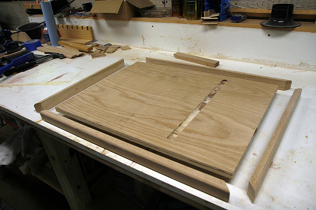

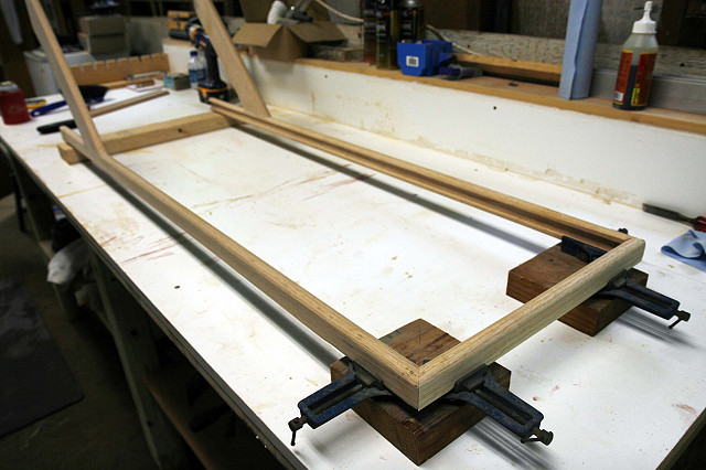

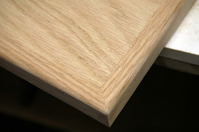

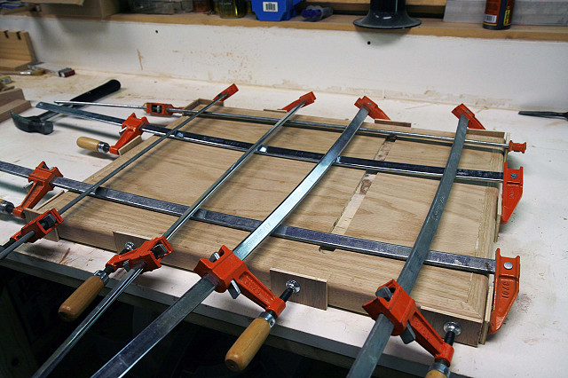

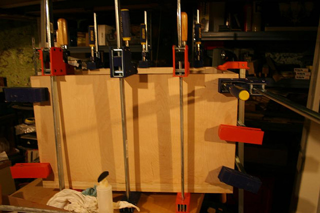

Started gluing up my bins today.  One is all clamped up.  Biscuit jointers rock!  It was SO much easier to put a big box together while keeping everything mutual orthogonal with the biscuit joints.  Not to mention they make the joints stronger.
The baffle hasn't been glued on, that will be after the driver hole is machined and the oak cross braces have been added.  Babies are going to be HEAVY!  Glad I used 1.5" baltic birch on all sides but the baffle (2.25" BB/MDF sandwich) as the BB is lighter, although still heavy.
Wife commented that she saw my boxes and they are huge.   :icon_lol:  Her reaction was better than I thought it would be.  It wasn't a "no well in hell."
