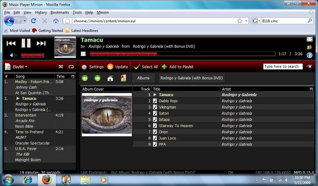

Guys, thanks to ashok I gave MPD a shot with ioBox, specifically using the Minion plug-in for Firefox.  It is awesome!!  Playlists, gapless playback, easy to browse my library, its all there.  Check this out:
Good stuff.
-Jim

Jim, this looks way cool. After reading your and Ashok's posts I took the plunge and mine arrived today. Now you need to write up exactly how to get to where you are so I don't have to search a ton of thread on networkedmediatank.com. Self serving request? You bet. :-)
Good stuff.
-Jim
