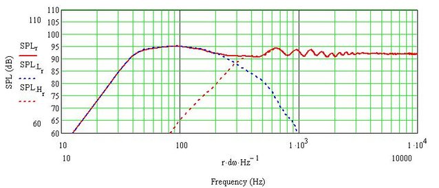

A simulation with the ScanSpeak unit:
This should be fine. I have investigated 2nd order crossovers a bit more and would recommend 2nd order Linkwitz-Riley at around 250 hz which will take down the 2 kHz peak in the Alphas to a sufficient low level. 5 mH and 122 uF for the Alphas and 70 uF and 4.7 mH for the Revelator should be about right.

« Reply #91 on: 13 May 2009, 08:35 pm »
With the MJAO 2nd order filter for the Alphas took down the level a bit too much to match with the Monacors so I preferred to stay with 6 dB slopes. Here it seems the Alphas could be taken down some dBs to match with the ScanSpeaks. Also with regard to my trouble with the simple crossover for MJAO I was curious to measure the 2nd order filter and it will perform brilliantly without notch or Zobel which is a comfort.
