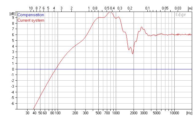

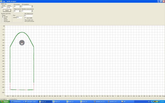

The flat section at the top is not there by mistake it helps minimizing diffraction. A rounded top would have been worse.
Erling (and for that matter everyone that has been posting information about their projects here,) I've found it all very interesting and am contemplating putting together an OB along the lines of The Anagram at some point.
Would you be kind enough to explain to a relative simpleton why the above is so? Would a square or angled baffle be 'better' than an gently arched top then acoustically? I'm sure there's probably a very obvious reason but it's useful to understand it (mainly so I can explain it to the wife when she starts commenting on the appearance!)
While I'm here, could I ask you what the useful lower frequency range is? I'm guessing somewhere around 40 Hz?

I'll try to illustrate with an example with the Edge program, that illustrates diffraction effects of the baffle. Edge is here: http://www.tolvan.com/edge/ .
First a baffle like the MJAO but with a rounded top and the midrange placed in the middle at the same height as in the MJAO.
resulting in diffraction effects from the baffle like this:
You can do guite a bit better by manipulating baffle shape and speaker placement. You will however always have some kind of dipole effect with a hump in response. But this rounded baffle top is not the best you can do.
It should also be pointed out that this is pure theory and real life measurement in a listening room can very well prove it wrong.  :)
/Erling

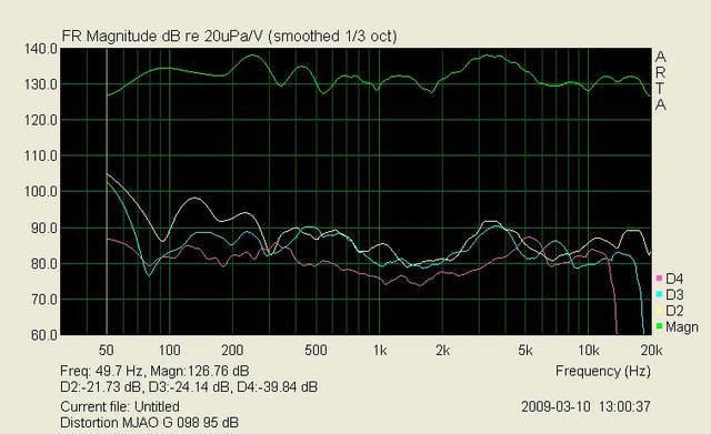

I also have taken some distortion measurement of the MJAO . These are just one meter closer to the speaker (right one) and mic is pointing to somwhere in the middle of the baffle a little above woofers. Frequency response is a bit different from the sweetspot measurments. Also German Klang & Ton in a rewiev of ARTA stated that distortion mesurements should be taken more near the loudspeaker.This is the picture, 95 dB avarage SPL:
-40 dB is equal to 1% distortion - 50 dB is equal to .3% distortionm and -60 dB is  .1 % distortion
/Erling
