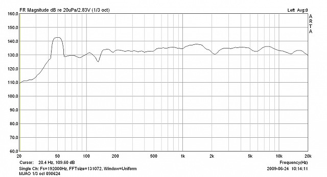

In my measurement of today bass is some dB below mid and treble - on average, revised crossover, and always has been. It looks like this:
This is the response in my livingroom. It might not be a good idea to put resistors in front of the Alphas which will increase Qts a bit and may be introduce a boom. If you know how many dBs you would like to adjust then an impedance neutral L-pad can be calculated.
Erling

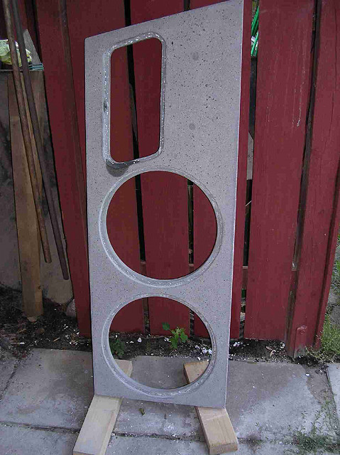

Kludden
Re: MJAO G 098 - The Anagram - Crossover revision
« Reply #107 on: 9 Jul 2009, 09:56 am »
As a tribute to Scorpion i will build a copy of his MJAO in concrete.
One baffel build
Regards
Per
scorpion
« Reply #108 on: 9 Jul 2009, 06:52 pm »
Hi Per,
Did a stone fall from my heart or am I stoned ?
You have at least heard the original at our Gothenburg DIY Show. I am impressed by your concrete abilities, it does look fabulous, hopefully the sound will match.  :)

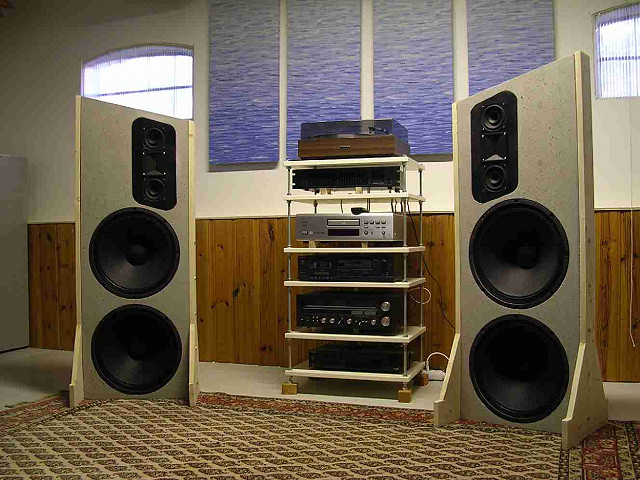

Kludden
« Reply #119 on: 7 Sep 2009, 09:13 am »
Hi!
I could just agree wit Jkelly. This speaker suonds amazing. Thanks Erling.
My copy of MJAO made in concrete.
Regards
Per
