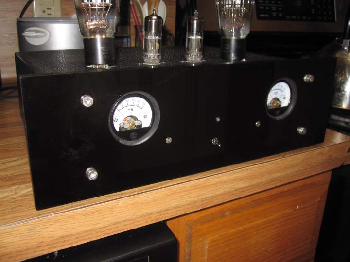

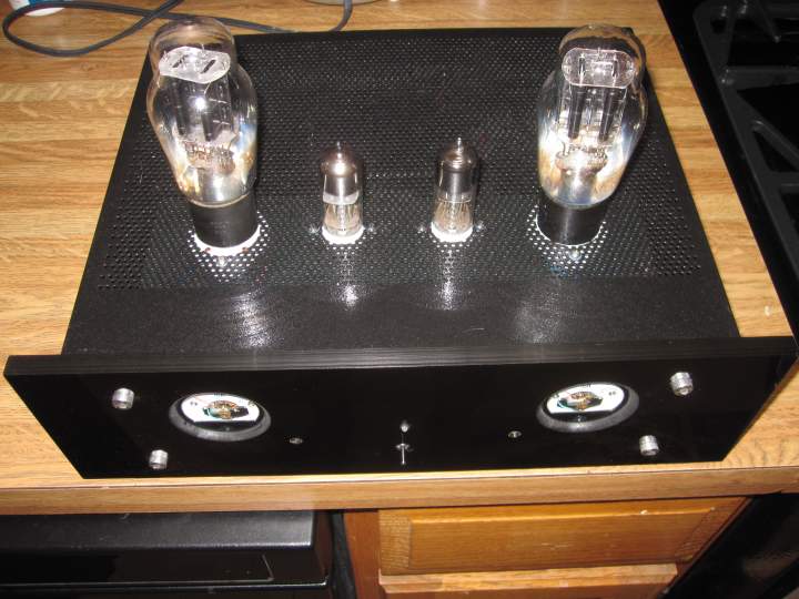

6A3 / 6H30DR    :thumb:
poseidonsvoice
  • Posts: 4032
    • 2 channel/7 channel setup
Re: What equipment have you built recently?
« Reply #161 on: 11 Aug 2012, 07:17 am »
2 stage SET? Nice. Keep it coming... :D
Schematic?

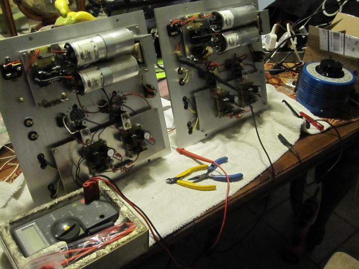

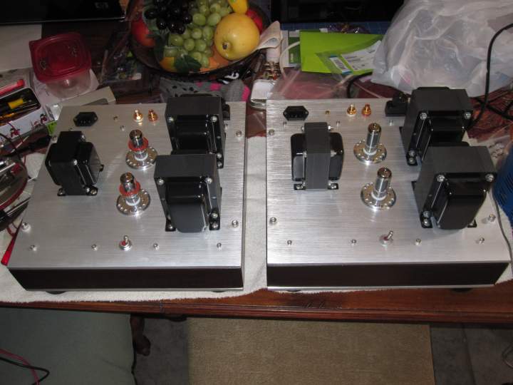

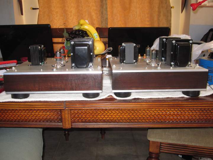

Finally finished two matching 6CL6 SEP.
Sound awesome and quiet.  :thumb:

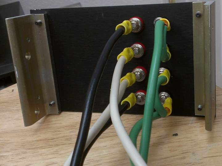

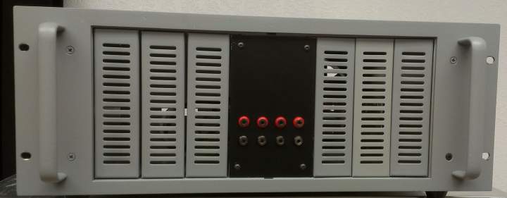

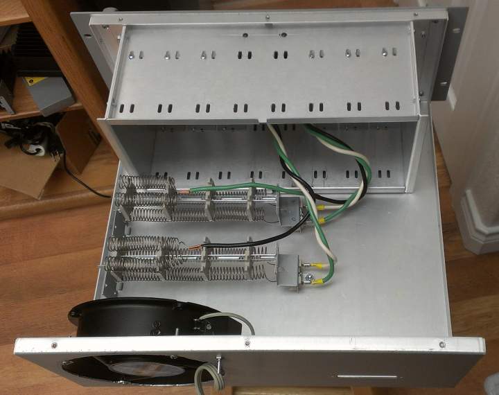

For years I've been using plain old resistors for amplifier loads but the largest I had was rated at 100W and they became hot very quickly. Some Google searches turned up a suggestion to use heating elements as loads. A bit of searching on Amazon turned up some Emerson/Maytag dryer heating elements. They are rated for 4750W each, no issues with capacity and just over $20 each delivered, so worth a shot. One thing that was an unexpected bonus, the coils are wound in opposing directions for each row, making the load essentially non-inductive. The LCR bridge shows only about a 20mOhm difference between 100Hz and 10kHz, close enough.
The overall resistance is about 10.6R, so I simply measured from each end to find the 4R point, cut the coils at that spot and tied them together along with some 10GA wire. This allows for 8, 4 and 2 Ohm loads with various jumper connections. I finally got around to mounting them in something non flammable and with plenty of airflow. I purchased the chassis from JoshK many years ago and we used it at work for a drive array until recently. It was going to the trash and it occurred to me that it would make a dandy housing for this purpose. All the other components except for the fan and banana jacks were scrap bits; much to the agony of my wife, I am a pack rat. The front plate was some leftover 2U rack mount panel, the brackets one the wire end of the loads were from a failed transformer, the other brackets from a dead amp, they originally held some heat sinks. Some aluminum angle for the panel mount, no idea where it came from but it was a freebie, some extra holes but they don't matter.  :lol:
Not pretty, very industrial but works well. The fan is rated at 195CFM and even with 1200W into 2R I didn't have any heat problems. :) The best part is I have less than $100 invested, excluding the original cost of the chassis and that has long since been recouped.

Do heating elements change resistance with temperature?
mgalusha
« Reply #173 on: 26 Aug 2012, 01:29 pm »
Yes they do and that is why I put the biggest fan I could fit into the case. :)
I did test it, the measured resistance changes by about .1R after 10 minutes with my heat gun on high and no fan running, the chassis and the elements were very hot after this time. The IR thermometer showed the element at about 100C but that cannot be 100% correct as the IR probe is calibrated for black body radiation, so it was possibly hotter.
Shutting off the heat gun and engaging the fan caused the resistance to return to normal in less than 20 seconds, so during normal use I don't expect much change; the fan will of course be running before any testing occurs and for THD+N vs Power sweeps, the amplifiers are only pushed to high power for a few seconds, even when using a 100 step sweep (the default is 30 steps).

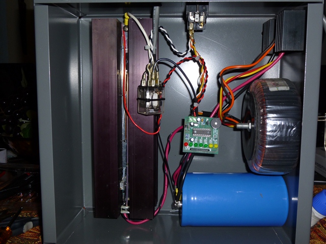

12VDC Linear PWS 15A
