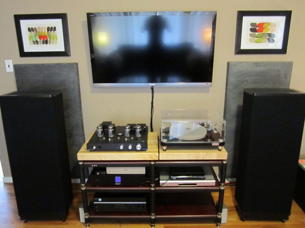

Hi. This is an isolation/choice of TT question. My Rega RP1 (on a Solidsteel 3.5 rack) and REL T2 are talking to each other (the passive radiator in the sub 'motorboats' when the sub's volume is high enough for the REL to do its job). This only happens when I'm spinning vinyl.
The floor seems to be the culprit: its an engineered wood floating floor, resting on resilient cork underlayment. The cork is in turn laid w/o adhesive on 1 1/2" of gysum concrete. Beneath the gypcrete is 3/4" plywood nailed over TJI engineered wood floor joists.
When the music is playing (from any source), I can feel the vibration in the wood when I place my hands palms-down on the floor. Heavy footfalls from anywhere on this level of the house (2d floor) resonate dully throughout, and you can hear the low-frequency vibration from them on the first floor.
I am considering both short-term and long-term fixes for this problem. Short-term, how about one of those 4" air-dried maple sub platforms with brass footers from Mapleshade? Long-term, do I need a suspended design TT like a SOTA or a Linn?
Thoughts?

Yes - it sounds like your non-suspended Rega could use some isolation from its rack....it's locked in and taking the brunt of what the sub is putting out.
I use a 3.5" slab of maple cutting block with brass toes pointing down into it from my (non-suspended VPI) deck. The effect of maple and brass toes is transforming to a vinyl system I found.  Look at another topic here in the past couple days about Dawns Maple Platforms before you sink your money into a Mapleshade product....mine is from Dawn and the cost was more than 50% less thru her than Mapleshade for substantially the same thing (a thick maple block)
In your case, under the maple block you may want to invest in some further pliant isolation: cork/rubber feet such as found in HVAC supply stores (normally go under major appliances to quiet them), or there are various (silicone) Herbie's Grungebuster products (they are a vendor here on Audio Circle - look for them) for more money, but they may provide even better isolation.  I use Herbie's and have always been pleased with their effects.
Steve Herbelin is the owner and a chatty guy so I suggest speaking to him and getting advice for your specific situation (after you invest in the maple block and brass toes...cheapest that I know of are from Parts Express)
Cheers, John
« Last Edit: 19 Apr 2012, 06:46 pm by TheChairGuy »

Thanks for the fast reply, John. I'll check out Dawns maple products, and check in with Steve also (I'm using his Way Excellent mat and like it).

Yup - I use his mat, too.  I tinkered around with SO many of those over the years.
Once I found his, I simply stopped.  There may be better out there - but, I found Herbie's mat was simply good enough for me to concentrate on other deficiencies in my system.
I have the end grain, 3.5" thick rectangle block that Dawn sells....I think with shipping it's like $110 to your door.  Some claim that the air-dried, solid maple blocks are better....I haven't tried them to know.  The end grain was so good there too, I stopped tinkering around with better supports under my turntable.
Cheers, John

ever thought about a wall mounted self like a Target
I don't have your problem with my tt and subwoofer talking to each other, but i do have a flooring issue.  We have beautiful old wood floors in a 100 year old home and with my system set up you could not walk around in the room while spinning vinyl.  The wall mount shelf solved that issue well.
cheers,  Jim

Thanks, Jim. I'd forgotten all about that option. It might be impractical for me, tho', since I've got the MMG's about 5' off the front wall to capture that 10 ms delay . . .

That is, my cables wouldn't be long enough (the speaker cables are 8'). I've currently got the equipment rack in-between the speakers, to take advantage of the dipole's null spots and minimize acoustic feedback from the back of the panels. If I move the rack back near the wall when using a wall mount (to connect the RP1's short integral tonearm wire to the amp), the speaker cables would be too short to have the speakers where they sound best.
cheers,  Jim
Same here, I have a 2 shelf Linn unit. I have my TT on a 2" spiked butcher block on top of it, phonostage below. I can jump around and not even the slightest bit of effect. I did however use rubberized fender washers under the screw heads and thick rubber grommets between the shelf and wall. It does everything it's supposed to do.
