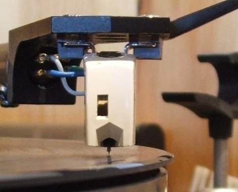

I'm still a newbie at heart. Will be setting up a 10.5i VPI tonearm soon and am wondering about everyone's favorite azimuth adjustment methods. Right now I'm leaning towards the Fozgometer.
Paul
To save on the squinting on first set up I tend to take a little digi pic just to help verify.
Pop the camera on a stand/tri-pod and take a head on snap (max resolution on macro).
I typically just delete them once set up, here's one I kept though of a Stanton 881S.
Probably not the best pic I've taken (normally get in a little closer), but you should get the gist.
The hardest part is getting the camera to focus on the diamond - this takes a little patience.
I use one of those little 30x mini telescopes (inverted) to check by eye while setting up.
The Digi pic is a little over check.
Good luck and  look forward to hearing your thoughts once up and running.
