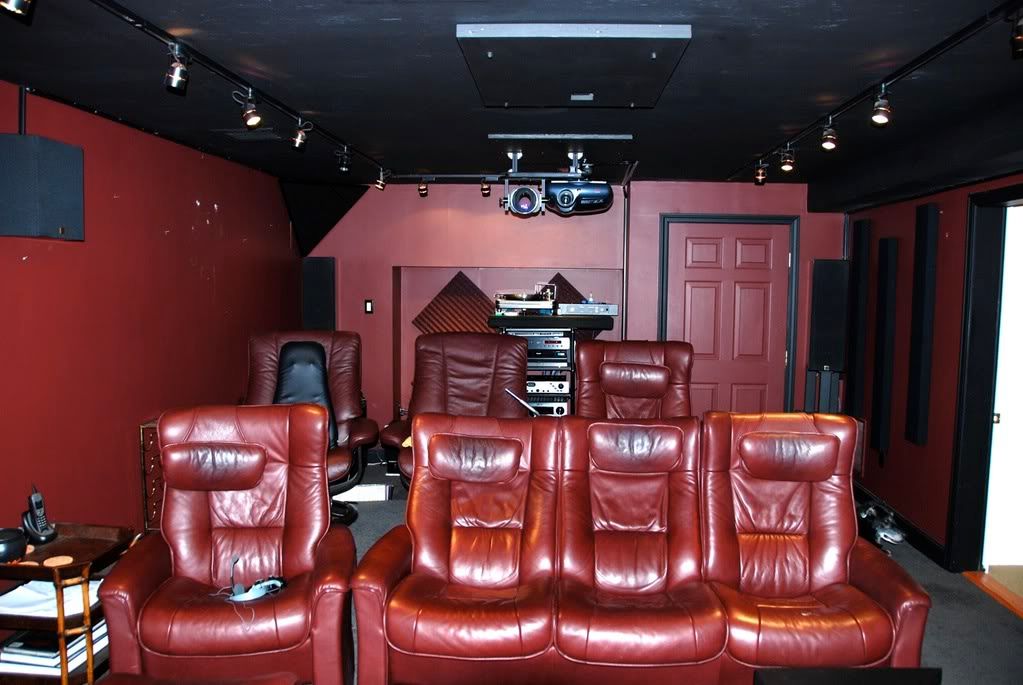

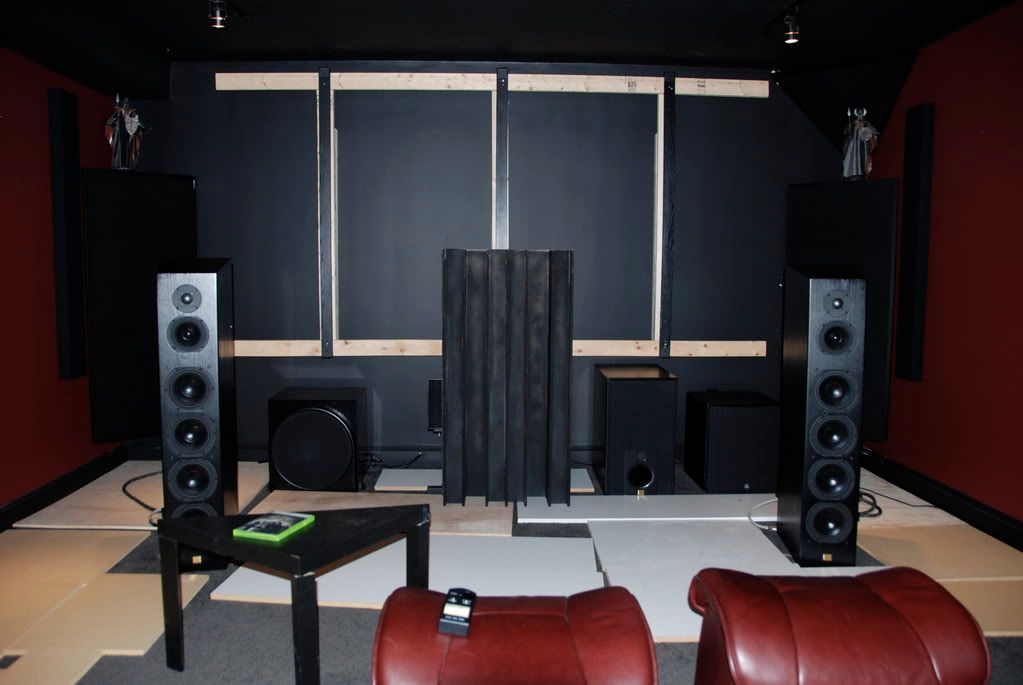

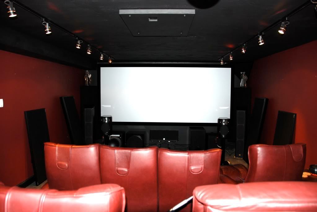

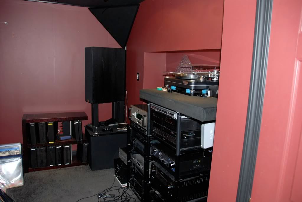

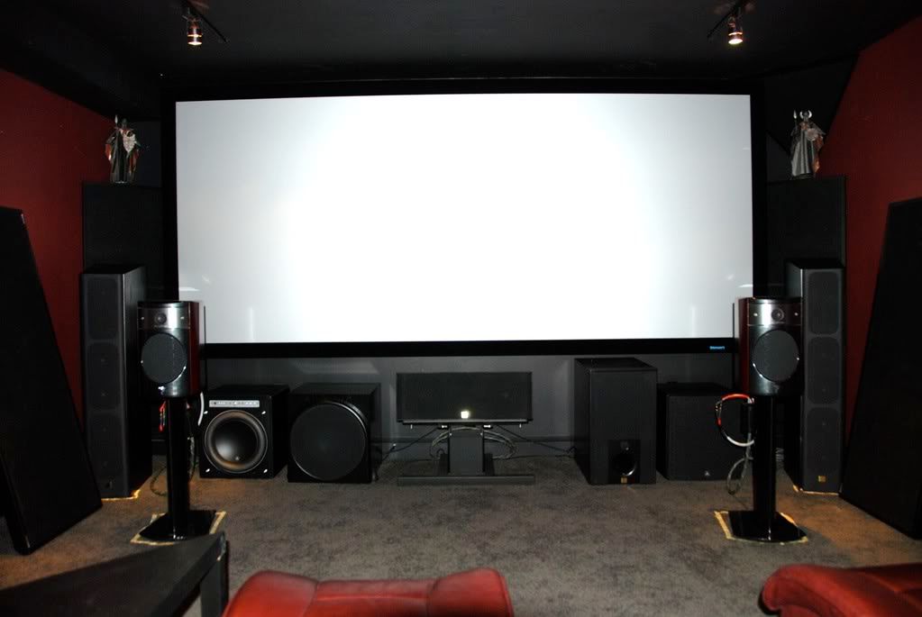

I thought I'd add some pics of the room.   I am considering removing the carpet - or perhaps the front 1/3 of the room (and replace with hardwood).  As an experiment I laid down pieces of plywood in the front of the room (up to where the speakers are placed) and it helped the high frequencies, but not necessarily the upper mids.   I also tried removing my screen and I think it helped some (I only had a limited window of time to do audition this, so I'm not certain).
Here are some pics to give a sense of the room.
From the listening position:
Further back:
The rear of the room:
Close up of the funky alcove where my equipment rack is:
Here's the experiment with plywood etc on floor and screen removed and a friend's diffusor sitting in between speakers:
Note that in these pics most of the ASC wall planks have been removed.   I'm thinking of adding diffusors to give a bigger sense of space and liven it up.   Where are the best places for diffusion?
Thanks again,
Ian
