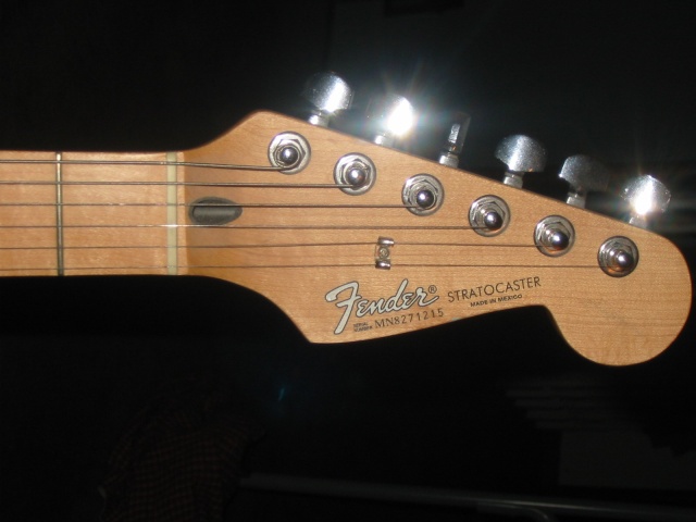

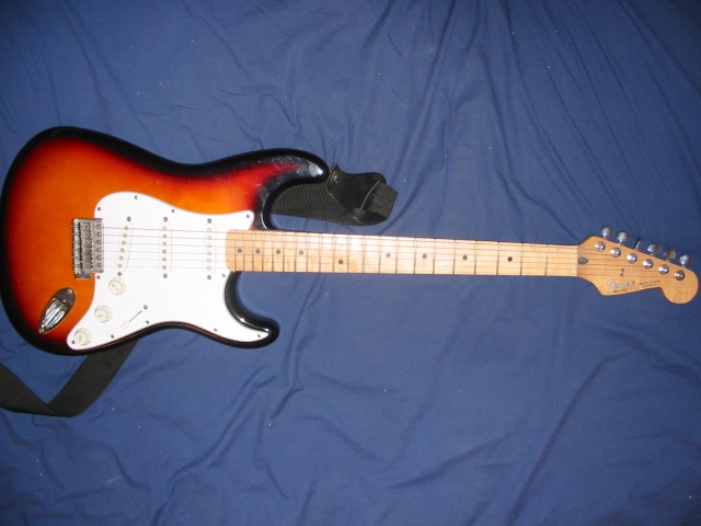

Well, here are a couple of pictures of my Strat (mexican std.)  The sad thing is, the last 3-years while in law school, I barely touched it.  I really regret that.  I need to take it in to get adjusted before I pick it up again.
I got this 4 or 5 years ago as a Christmas present. . .I was blown away.  It is really beautiful and I miss playing it.

Here are some pics of the tremolo. . . it is supposed to be level w/ the body, isn't it?
I couldn't get the digital to focus on it, but here are the best ones. . .see how the tremolo is not even?  I really never even used the damn thing. . .the handle hasn't been on it in years.  Do you know anymore about this kinda stuff?
The screws on the tremolo also need to be adjusted (to adjust string height). . .I found something online to do this, but I don't think I did it right.  I did adjust the neck screw a few years ago b/c of a slight bend in the neck.  I just have no experience in these things, so I just have to get my butt to the guitar shop.

Nope, the trem can be set up with the back section away from the body slightly.  Mine was set up like that at one time.  If it goes out of tune a lot, try setting it up with all five strings in the trem (back of guitar), and put some soap (or powdered graphite) on the strings in the headstock.  Those little string guides are often the culprets that cause some strings to go out of tune.  They catch on the strings slightly and cause problems.  Those screws on the back of the bridge are for adjusting intonation, not raising strings off neck.
Take it in to a good independent guitar shop and they will help you out.  Get it completely set up by a good guitar tech.  They will adjust the bridge, intonation, truss rod, throw a good set of strings on it, etc.  It's worth the money, unless you know what you are doing.  Too bad you live so far away, there are several good tech's in Chicago.  Strats are almost indestructable, however they need to be set up properly or else they are no fun.

I just remember the tremolo not being set up like that before.  As for the intonation. . . I adjusted that a few years ago. . . I thought I remember it being for string height. . .I got some measurements and did it. . . Yeah. . .I definitely need to take it in. . .the place my parents bought it in KC is a good place. . .I just need to get out there.

It's okay for the trem to be away from the body at the rear end, however if you are saying it's not pulling away paralell from the body, you may have a problem.   My strat bridge floats a bit, however the strings are all the same distance from the fretboard.  Sometimes when I have an effect on like an autowah or echo, I'll hit the bridge with a closed fist to make a strange sound.  It doesn't knock the guitar out of tune and sounds a bit strange.  Try it!  It won't break your strat.
