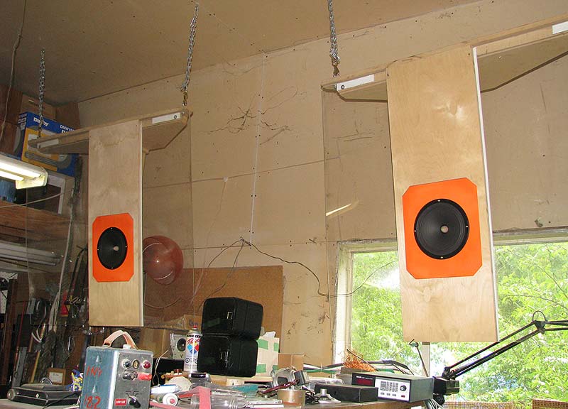

Something like this (in my shop)?
dave

Hey - Look at that!   I remember those. ^_^

Here is a more recent shot with the halloween treatment of the drivers
dave

That is exactly what I am talking about! :o What kind of drivers are those? How well do they work for you?
They are a set of Omnes 8s. They measured very well when measured at the diyFEST last summer. I have them a little close to the back wall here but they rock when i crank it. The from the ceiling is largely a place to get the baffles out of the way.
Now that i have had a chance to listen to them, and to play with treatment schemes (mostly the colour on these) they are available as clearance stock... i have a queue of other drivers to pop into the OBs.
