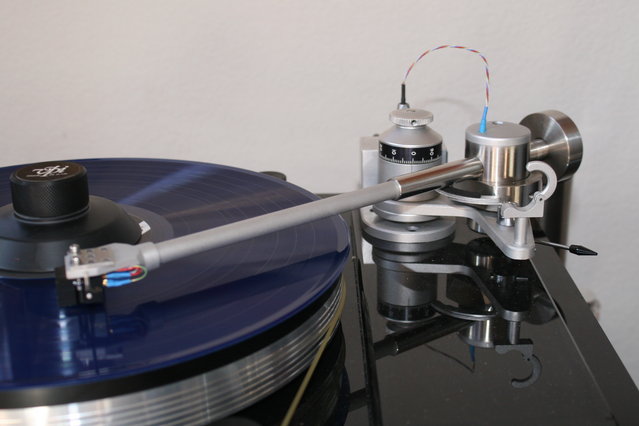

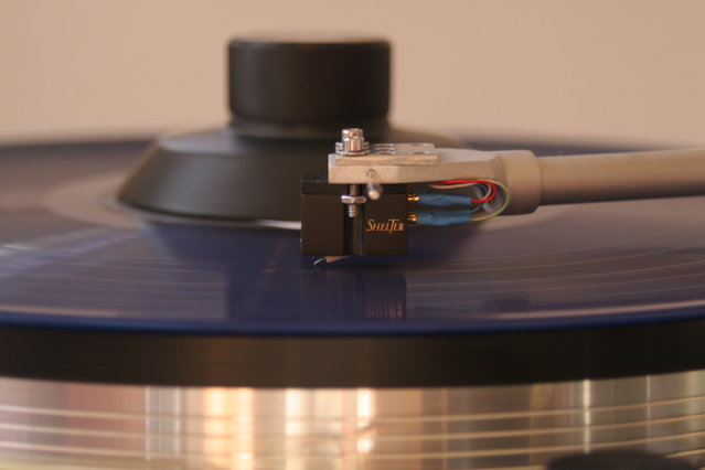

Sonny
Re: VPI JMW 10 and Shelter 501 Mkii set up
« Reply #11 on: 12 Jan 2009, 05:37 pm »
here are some image of set up.

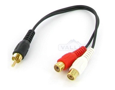

If your phono stages doesn't allow loading then one quick experiment is to buy some RCA Y-adapters that have 1 RCA male plug on one end and 2 RCA female jacks on the other end.  Then you make up some RCA plugs with different resistors in them, for example 20 ohms, 100 ohms, 200 ohms, etc.  Plug the cable from the turntable into one of the RCA jacks and use the other jack for the different loading plugs.  You can then experiment on the effect this has on the sound.  The jacks degrade the sound a bit so once you've found a resistance value that you like then you are better off soldering this directly into the phono preamp.
