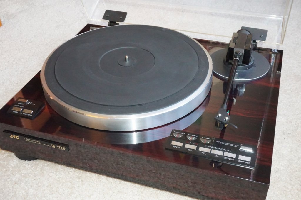

I found one this turntable for $300 last November, loaded the plinth with as much material that I could insert.
I used a combination of plastic clay and multiple layers of peel and stick vinyl floor tile that were cut to size and stacked from the bottom of the top plate to the bottom cover. As a result the bottom cover has maximum contact with the clay and vinyl tile with absolutely no vibration. Rapping the sides of the plinth is very solid without the hollow sound was was initially present.
I added about 12 pounds of total material and the total weight is now a hefty 43 1/2 pounds. I did not change the stock feet; however, the table sits on a solid 3 inch maple block.
This is a fantastic sounding table!

That looks like it's in perfect shape. I also have the straight tone arm, and evidently the extra weight and S tome arm were lost during moves when my friend had the TT. Mine has some scrapes on the dust cover and the top of the plinth due to being bounced around with the platter loose between the two. Still it's in really nice shape if you don't look too hard and plays nice. Nothing peeling or anything like that.
WOW, almost 50 pounds!! Crazy.
I ordered some VIBRAPODS so I will see what happens with those and the DYNAMAT when they get here. How did you get all that stuff inside yours without getting in the way of all the electronics and tone arm etc.? Must have taken some time and patience. I'll put up some pics once I get it all done and get some time to do so. I'm still a working man unfortunately.

The guy I bought it from, had it for many years. I told me that he did not like the JVC brand, since he associated it with cheap stereo equipment, such as the mass market stuff at Best Buy. It told him it wasn't the case. He just sold it to me at his purchase price. Since everything worked and even the interconnects were perfect, I did not have to do any repairs.
There is surprisingly lot of room in the plinth just fill in as much as you can. Stay away from getting too close to the tone arm mechanism since it swings. I found careful placement of layers of peel and stick floor tile working from the inner top plate and inner sides that are cut to size is a good place to start. Go all of the way to the bottom of the pinth so that the bottom cover solidly rests on the tile. Once done, fill in the voids with the clay. Some of the edges of the electronic boards are also encased. All of this stuff can be removed later if there are any problems.
I got my plastic clay at Michaels. Find the thickest vinyl tile. I found some on Amazon that was 2 mm thick.
