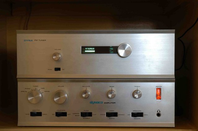

January 8th, 2009 - Update:  "Let's FINISH This Thing!"
     OK, it's time to "Fess Up!"  I mentioned my little *goof* previously.  Here's the whole story!  First, take a look at the initial picture of the Main Chassis with the circuit boards installed:
     Now, here's a picture of the completely wired Tuner:
     Look VERY closely at the top of the main Filter Capacitor.  Notice a change?  Yep!  I had *originally* planned to use our familiar 80-40-30-20 uF filter capacitor.  The only problem is - it's about one-half inch TALLER than the cover for the tuner!  That certainly didn't even enter my mind - at first!  Of course, it was immediately OBVIOUS once I attached the Front Panel to the Main Chassis.  Rather than punch a hole in the perforated cover (just kidding!), I replaced it with a "less towering" capacitor.
     I know the camera angle makes it nearly impossible to see the difference.  Fortunately, (for my pride) I didn't snap a picture of the original capacitor choice, TOWERING over the top edge of the Front Panel.  But UNfortunately for my pride,  I truly believe in "full disclosure" - warts and all!  Besides, I *knew* everybody would get a kick out of my stupidity, right?  Of course, discovering this little "catastrophe" at the "Eleventh Hour" didn't do much to improve my outlook for the weekend, but it only took about an hour and a half to "correct" my little "faux pas."  I *did* get a chance to hear the tuner with the "wrong capacitor" installed.  The funny thing is, there was virtually no difference between it and the replacement capacitor.  The replacement is a 40-40-20-20 uF capacitor - the original values Dynaco used.  When Dynaco got it right, they really got it RIGHT!
     But that brings us to *one* area where Dynaco got it wrong.  I also mentioned previously that we were going to "correct" Dynaco's *teensy* little goof.  Well, this is it!  Take a look at the wiring to the two RCA jacks on the Rear Panel of the tuner:
     This is NOT the way Dynaco wired things.  Dynaco used small RCA Jacks that grounded the shell to the chassis.  They used the chassis as the low side of the RCA's.  No wire, no nuttin'!  But the chassis is *also* used as one side of the filament wiring for the RF and IF Circuit Boards!  ANY resistance ANYWHERE can lead to hum from the Output Jacks.  If your tuner has a mysterious case of hum that you simply cannot eliminate, *this* is the most likely cause.  In this particular tuner, I decided to insulate the RCA jacks from the chassis and ground them to the ground point for the 12AX7 Output amplifier V72 - the center pin of the tube socket.  This point is wired directly to the Main Ground at the terminal strip.  The result?  Not a TRACE of any hum.  Nothing!  Nada!
     By the way, it probably isn't necessary to use insulated RCA jacks, but it IS necessary to run the ground for the jacks back to the Multiplex Board's ground point.  Don't just leave the ground side of the RCA's connected to the chassis alone.  Your tuner might not hum NOW, but it is almost GUARANTEED to hum sooner or later.  You'll think your quad cap is bad, but it isn't.  You'll think the last 12AX7 has developed a Heater-to-Cathode short, but it hasn't.  You'll imagine all SORTS of probable causes for the hum, but you'll overlook THIS one - the REAL reason!  It wasn't a HUGE goof, but it WAS a goof on Dynaco's part.  This fixes it, once and for all!  If you have a tuner that hums a little, try this fix FIRST!
     So, now all we have to do is complete the "cosmetic" portion of our tuner build and align the beast.  You already saw a picture of the Front Panel and the Main Chassis.  Here's a picture from the rear of the unit:
     Sorry about cutting off the right side of the image.  The thick rubber band that is currently holding the battery door closed on my camera covered up that portion of the viewfinder screen, so I had to *guesstimate* the width of the tuner.  I just guessed a little *under*!  Anyway, here' an overall shot of the tuner from the rear:
     Yep!  Looks like a tuner!  But not a *finished* one.  For that, we need just a FEW more parts, like the Bottom Panel:
     Other than a few fingerprints from the "cleanup phase", this panel looks pretty good.  Now, here's another item you won't see every day - a NEW (NOS) insert for the window in the Face Plate:
     Speaking of the Face Plate, here is our cleaned up Face Plate, along with the knobs and hardware used to attach it:
     Dynaco NEVER issued a tuner with these knobs.  They used the original style die-cast knobs.  The FM-3 was discontinued before these machined aluminum knobs were ever used on a Dynaco product.  *I* used them because this tuner is going to be paired with "The Last of the Dinosaurs" PAS-3X preamplifier and I wanted them to match.  Here's how the tuner looks with the Face Plate and knobs installed:
     I kinda like that "glint" of sunbeams that danced across the face plate in this picture.  But here's a shot of the completed tuner, ready to be packed up and shipped:
     Compare that with the picture of "The Last of the Dinosaurs" PAS-3X preamplifier:
     That's a match made in heaven!  And that wraps up the construction of our first FM-3 tuner!  But, we have one more update to go - namely, the alignment of our tuner.  I'll cover that in our final update, coming up shortly.  If you were wondering how tough it is to align an FM-3, take heart.  It's a piece of cake!  Honest!
Sincerely,
Bill Thomas

katabatic
Re: Dynaco FM-3 rebuild - "A Double Dose of Fine Tuning!"
« Reply #36 on: 25 Jan 2009, 12:45 pm »
Bill--
There's a secondary data sheet on the site that shows the diameter as 40mm, or 1.575 in., which is wider than the stock unit  I checked my tuner and you're right, it is very tight around the cap, but it looks like a 40mm can would just clear everything, and the listed 60mm height is actually a bit smaller than the can that is in there.  I'm going to bite the bullet an order one...I was going to try to make the SDS Labs cap board myself (I've never made a pc board before--whoa, toxic chemicals and even more chances to electocute myself) but this alternative seems easier and safer (hey, I can send an email to Germany; I can do THAT)  I'll let you know when the thingie arrives in the mail.
George
katabatic
« Reply #37 on: 6 Feb 2009, 04:08 pm »
Bill--
I've now received the can cap from AskJanFirst (link above), and it fits, both in height and width.  The new cap is shorter but wider (40mm wide) than the stock Dynaco part:
But, it clears the power transformer, the tuning shield, and the front circuit board (and fits the slots in the chassis perfectly)...Sorry about the rust spots on the chassis; I'm working on it....
Hooked everything up, flipped on the power, and WETA-FM came up loud and clear!  It's been part of a broader upgrade with new output caps, PEC modules, and those nasty resistors on the front board that caused you such grief.
Hey, no smoke, no flames, no need to call 911; it's a good day.
Cost of the cap can, with shipping, was 39.70 Euros, or about $51.00.  Not the cheapest alternative, but one that looks right and drops right in.
Only issue now is that when I tap the tuning knob, I can hear the tap through the speakers.  Didn't do that before.  Oh well, something to track down...
George
