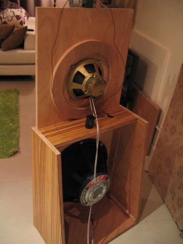

new here.
I use a celestion ftr18-4080f 18" woofer with my Telefunken Oval 11 x 7 " fullrange and a rare isophon 13cm paper tweeter on a open baffle. Shallow u-frame for the 18" woofer and plain board for everything else.
I tried Lampizator's p17 xover. I had problem in matching the sensitivity of mid and woofer, so sometimes i use a VR to attenuate this. The sound is nice. Good thing about this is that I could use my wonderful Nuforce V3 integrated for everything. The bad thing is that there is no way i could add some bass boost that i could with my Reckhorn S-1 crossover when I go active.
I am still in the middle of fine tuning my crossover point. Though I want to follow Lampizator's p17 all the way, I just don't have the same woofer so the safer bet for me would be to go active for the woofer. So most of the time I drive the Telefunken oval (sometimes the gold color Grundig 9") with my Nuforce v3 and put a series 200uf cap to protect the fragile telefunken oval from deep bass below 150hz. Then I drive my 18" open back woofer with Hypex UCD700, crossed around 150hz @24db/octave, with 10db bass boost added to 40hz. My baffle is 50cm wide and 120cm tall.
I am happy with the sound so far. But i think i can still fine tune the xover a bit. I am waiting for Nelson Pass's OB-oriented active crossover B5 to come through.

a peep from the back.  Qts for the 18" celestion is around 0.3.
