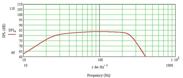

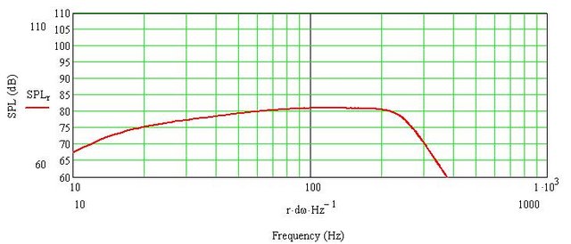

Let me introduce just two simaulations with these speakers. It is in a H-dipole 40x50x40 cm, 40 cm deep, 12 db/octave low pass at 100 Hz.
1st the Hawthorne Augie:
and 2nd the AE IB15 under the same circumstances:
This is interesting. There will be very little to choose between them.

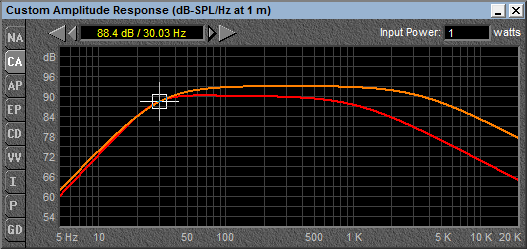

It looks like I'm a little late to the party again, but lets look at a few things.  First, simulations can help with the design goals, but in room results will always vary some unless the simulation would take into account absolutely everything, which it can't.  We'll break down each section to get the best results we can though and see what is happening at each point.   We can get a good idea what the baffle itself will do and the drivers will do, but placement in the room will also factor into the real world results.   I think it's important that in the open baffle world, you are going to need some kind of EQ or filters to compensate for the baffle rolloff no matter what you do.  We'll look at that a little farther down though.
Does anyone have full parameters for the Augie 15"?  It's really difficult to measure accurately without knowing Mms, Cms, Sd, and Bl.  All the other parameters are derived from these.  Without them we can't determine excursion accurately or max SPL levels.  In the interest of moving on though I'll make an assumption that the Augie 15 has the same Sd as the OB15.  We can always correct it later, but this will give a good start.
That said, if 30hz is the main goal for low end response and the upper end is only around 100hz, the OB15 would be my driver of choice. This is going to give you some extra efficiency up higher where you need it.  They can cleanly do 500hz or higher so there are no issues with the upper end response.  That said, we'll get a start on the comparison of drivers and output levels.  This will compare drivers only, not their open baffle response yet.

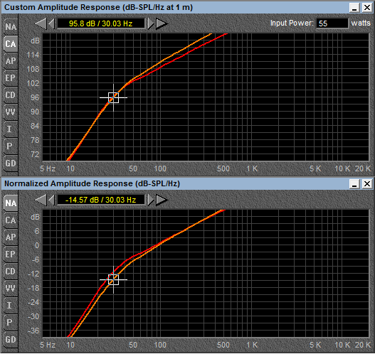

To do this we model with an infinitely large sealed enclosure.  I put in 10,000L as a good basis and model each enclosure.  You can see their response at 1W input here. The orange curve is the OB15 and red is the Augie.
The first thing you'll notice is that the OB15 has quite a bit more efficiency, about 2.5dB according to the 1W/1m calculated efficiency.  At 30hz though, the output level is pretty much the same at 1W between the two.  Since this is the low end limit lets look at that point a little bit more.  At 55W input, the excursion limits of the Augie15 are being reached.  This is at a level of 105.8dB.  The OB15 however has much more excursion available. It is not reaching the 18.5mm excursion level until input power of 400W and at a level of 114.4dB.  This is a total of 8.6dB more output capability at 30hz with the OB15.  Again keep in mind that above that point the OB15 is also more efficient.
That gives us a good comparison of driver to driver so lets look at the baffle alone.  To do this I'm using The Edge baffle simulator.  I don't have MJK's sheets, so I'd be curious to see a comparison between the two.  The Edge calculates only the baffle effects and nothing else.  I'm looking at a 450mm wide x 800mm tall baffle.  This will not calculate the floor effects but will give a good idea of the rolloff that is mostly determined by the more narrow 450mm width. The curve can be seen below:
Since we are only concerned with 30-100hz in this case, we can just concentrate on that region.  You can see the response is approximately -10dB at 30hz, the point we picked as the low end requirement.  This is the same no matter which driver we're talking about.  Subtract that from the infinite baffle model and you can see that the max SPL at 30hz for the Augie is about 95.8dB with that 55W max input power when reaching excursion limits.  At 55W input, the OB15 has nearly identical output at 30hz, but again you can throw 400W at it before reaching the 18.5mm excursion limits, allowing you to reach 104.4dB for the single OB15.
Now that we've looked at the output limits, we need to look at the EQ/compensation requirements.  Note that because the OB15 is more efficient up higher, the normalized response is down slightly more at 30hz than the Augie.  You can simply EQ out the extra output if you wish, boost the low end a little more, etc.  Either option though is going to require EQ to be flat.  You can see the response here at 55W and normalized to each other:

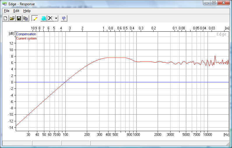

The baffle will be 420mm x 1300mm tall, with 4-40cm triangular back side wings. The bass driver will be placed 20mm high from the floor (wooden).
