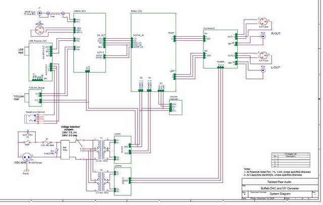

Well, clearly I am out of my league on this project.  I have never had a stand alone dac and thought I'd try one and picked up a Buffalo kit having done an amp kit long ago.  Silly me.  I assumed that assembling the Buffalo dac kit would build a functioning dac.  After receiving the thing, I quickly saw that not only was it not a complete kit, there were essentially no instructions  :scratch:- so I have someone else trying to figure it out.  Exactly what do I need to complete this darned thing!  I had hoped to use it with a Marantz cd 5400 and compare it to my Cambridge Audio cd player.  Are there no instructions for completion, or are you just supposed to know how these go together?
If someone has completed one, would they mind sending a PM with a parts list and a general direction of where to go with this thing.  Otherwise, I'll have to dump it.

The DAC module itself should be fully assembled.  After that, you need a power supply (did you buy a power supply kit with the DAC board?), transformer, some sort of IV stage (also available from Twisted Pear), power supply for the IV stage with transformer.  Then you'd need jacks and a case.
Depending on what you want to do with it, you may also need an input receiver (for USB or multiple SPDIF).
Twisted Pear also has their own support forum where you can find lots of other builders.  This link goes straight to the Buffalo section:  http://twistedpearaudio.com/forum/default.aspx?g=topics&f=19

The DAC module itself should be fully assembled.  After that, you need a power supply (did you buy a power supply kit with the DAC board?)Yes, it came with one, transformerWhat voltage and amperage?, some sort of IV ?? What is this?stage (also available from Twisted Pear), power supply for the IV stage with transformerOk, lost again.  It has one power supply. It needs another? :scratch:.  Then you'd need jacks and a case That I can handle.
Twisted Pear also has their own support forum where you can find lots of other builders.  This link goes straight to the Buffalo section:  http://twistedpearaudio.com/forum/default.aspx?g=topics&f=19 If my amp building friend can't figure it out, there is little hope for me. However, I'll make sure that he has the http for the forum.

Twisted Pear also sells transformers to match their power supplies.  I haven't built a Buffalo, but I've kept an eye on the product.  I believe their 9V+9V (15VA) Power Transformer is the one used for the DAC board.
The IV stage is required because the DAC is a "current output" type, which means it doesn't put out appropriate voltage levels to drive adio equipment and it needs a current-voltage (IV) stage to make it into a proper voltage output.  TP sells two products that do this, the IVY: http://twistedpearaudio.com/linestages/ivy.aspx and the Counterpoint: http://twistedpearaudio.com/linestages/counterpoint.aspx
The Counterpoint is still "beta", so you'd probably want an IVY (or any number of third-party circuits).  Their IVY kits include the required power supply, but make sure to order a transformer to go with it.  The DAC and IV stage boards have very different voltage requirements, thus to two power supplies.
Twisted Pear makes some neat and very modular products, but they do not provide step-by-step instructions.

Sorry, but it is 75 pages of stuff lacking a "how to" procedure or a specific parts list. It seems that if you don't know what a " LM4562" is or why it is prone to oscillation .....
It appears that the Buffalo dac is not a kit but a group of modules for the initiated to use in creating a dac.  My guy still wants to try it, but I think that I might be open to offers.  Apparently these are hard to come by.

For serious this may help
I can send you the PDF if you want
Wow! Now that's exactly what I needed!  Thank you so very much!
