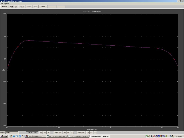

The tv is the large CRT.  At around 300 lbs it ain't going anywhere.  All the discussion about high frequency rolloff in the Alphas just doesn't concern me.  I've found by using my TacT RSC to generate frequency response curves that most system/rooms combos, that I have had, exhibit a natural rolloff in the high frequencies above 15K.  Also, using the TacT, I have created correction curves that produce a flat 20-20K response and let me tell you it is BRIGHT!  The best curves have a slope from the low mids to 20K of up to -6 or 10 db with most that occuring above 15K. I'd include a picture but I've forgotten how to copy the page into paint and then to a jpg.  Perhaps I can figure it out. When you only do it once every 6 months it's hard to remember.
BikeWNC
Smaller Alphas?
« Reply #11 on: 22 Nov 2003, 05:39 am »
Here is the E2 curve that is a popular starting template for room correction.  Notice the rolloff in the upper frequencies.
