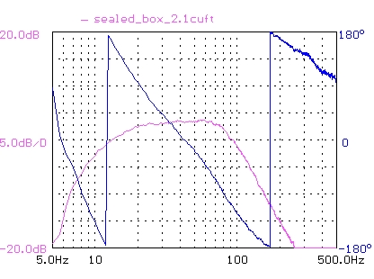

The Submersive response plot.
Below 20Hz there is 6-8dB more output capability beyond this measurement. (- a quote)
The 16-17hz figure I believe I saw somewhere, a user having measured his room and found it could do just about that #hz level
(I could remember wrongly of course)
Going down to 15hz CLEAN is not something that a lot of subs will do with much output, let alone there could be challenges getting ANY
sub to actually perform such a feat in the desired listening environment.
I'm thinking that 2gumby2 maybe needs to have someone assess his room to find the best course of action to accomplish his goal.
Getting 15hz might require some thoughtfull planning and effort!

You should be careful to analyze the amount of power and driver excursion you are going to need for that kind of curve in a small sealed box.   The small box is going to set the efficiency.   Even with a high excursion 12" driver you are going to quickly run out of stroke with SPL.   So the analysis has to include more than just your bandwidth, but your headroom requirements also.    You need about x4 as much driver displacement for each octave you drop to hit an equivalent SPL.   It doesn't take much of a mathematician to discover that what was suitable at a given SPL @ 40Hz, isn't going to cut it for the same SPL @ 20Hz let alone substantial output in the mid-teens.
I'd also consider it isn't unusual to have a good 12dB of room gain @ 20Hz.    If you design the system to be flat @ 20Hz you end up with a fat first octave.    I'd typically aim to start the system rolling off around 40-50Hz if you want to achieve flat in-room response.    The best method is to budget for room measurement and dynamic equalization capability because every room is a little different.    The Velodyne SMS-1 is a good tool that allows you to shoot your in-room measurement and gives you several bands of PEQ to shape the response for both the electronic equalization of the subwoofer/box and adjust for the room.   But keep in mind, there is no way to get substantial SPL down low out of a small driver.   The smaller the box you start with the more power it is going to require and the less ultimate SPL you are going to achieve.
