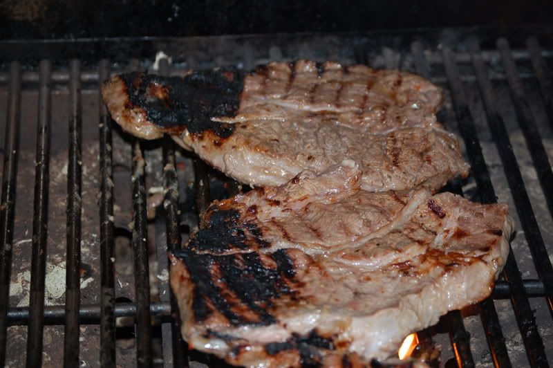

I've had my gas grill for about two years now. I'm SOOOooooo not impressed with gas.  :shake:
It's only had about three tanks of propane run through this $600 pile of crap and here's what last nights steak dinner looked like:
Not sure what five new burners cost, but this shiney stainless steel "tank" may get rolled out to the curb.  :evil: :finger:
I suppose I could look at the silver lining here.....I can cook one steak for two people, one half medium rare, the other half well done.  :lol:
Bob

Replacing the burner(s) is no biggie Bob, if your model isn't 20 years old like mine is. I had to do to my local Suburban Propane Co to order a new burner for mine. Before replacing it tho, try taking the buner out and running a vacuum cleaner on the flame holes. Ir might be that they're just plugged up. Of course if you find the burner body is have eaten away, then it's a new burner for you.  :thumb:

It looks as though fat/grease from the grill can drip down onto the burners? If that's the case you're always going to have problems unless you replace the grid type plate with something solid like a piece of 3/8 plate.
The best burner's I've used are the cast iron ones. All burners deteriorate slowly by clogging, which can be cleaned but also by gradual rusting out. The pressed metal type burners are hopeless in this respect as they rust very fast. Even stainless steel pressed metal is not immune to rusting out.
If you've got blocked holes in the burner you'll need something like a drill bit to clean them out. The burnt on rubbish is tough! You might also find that the [brass] jet which feeds gas into the burner [from the on-off tap assembly] needs a clean out. These are quite fine. You might get away with using a fine needle but a drill bit will be too big.
If the gas jet burner holes have burnt out and become too large you've certainly got a lemon on your hands.
