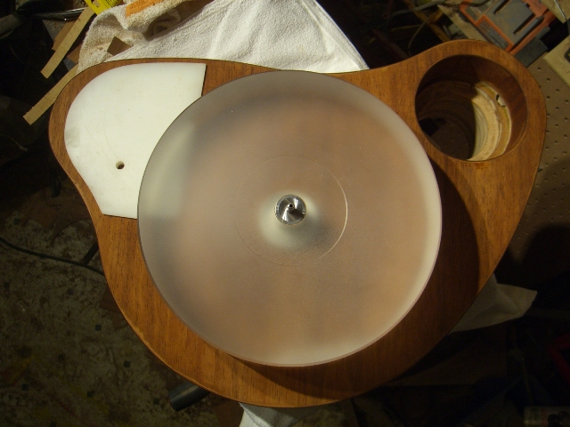

Thanks, I think it is the right thing to do.
One of the guys did if fact purchase the Set amp just for these speakers (it was not easy to convince him though). He got a nice deal on Consonance Cyber 211 monos (I've heard those......nice amps).
As to the TT in my avatar,

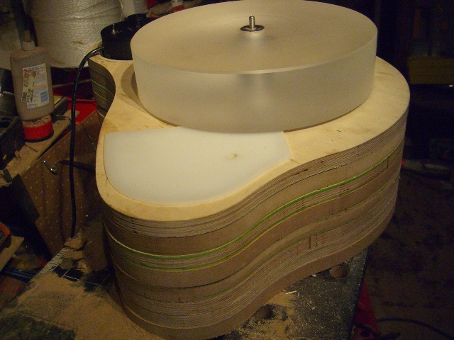

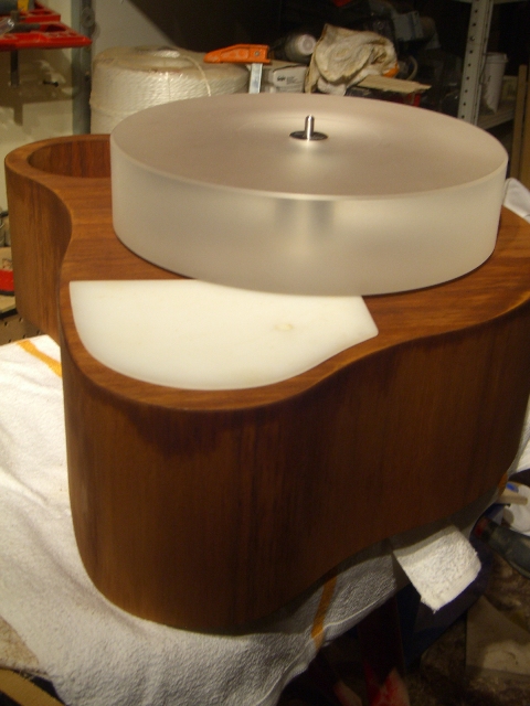

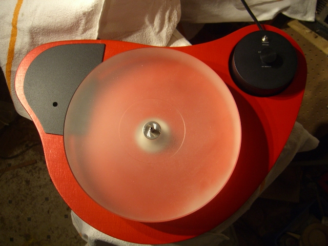

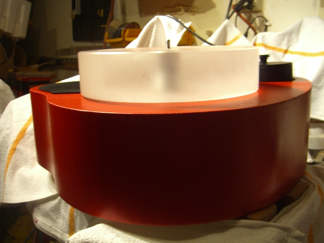

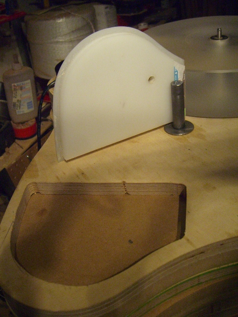

it is DIY table named "Red Devil". You can not see it (old pic) but it has a dedicated stand (same shape), acrylic arm-board and Moarch UP4 uni-pivot arm/Denon103R cart. It weights well over a 100 pounds. Sandwiched 11 layers of Baltic birch and MDF. Motor is not in contact with actual plinth to reduce vibration.
Here are some pics from the build process:

Very nice work :)
Mariusz
Re: SET amp or push-pull for SD speakers voicing
« Reply #7 on: 18 Oct 2008, 03:26 am »
Very nice work :)
Hey.....thanks.  :thumb:
Do what I can......within budget and skills.
It was my first (designed) turntable.....you know what they say about the first???  aa
Actually this one was my first modification.  :lol:
 I am sure you know what TT was used.  :idea:

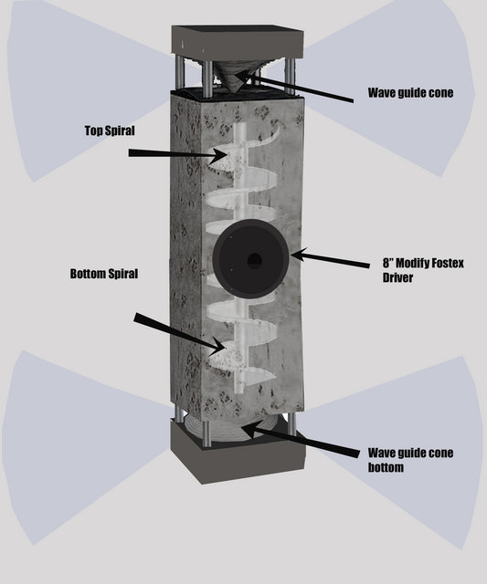

Here is the prototype speaker and my Lenco which is awaiting a brand new shiny plinth.
and
Sachiko based SD with super tweeter on top.
