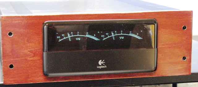

The ReBox project is completed and up and running.
The front panel on it is made of Lacewood
The project has changed a bit since I took this photo. I put aside the idea of re-clocking.
I added a second power supply just to run the network and display.
The Ultimate MKV is running direct to the Hynes regulator. The five volt runs just the analog of the DAC chip
The 3.3 volts off of the Hynes regulator rune the digital section of the DAC chip and the clock.
This removes ALL of the nasties from the internal switchers and the display from the analog output and digital section.
I added a step up transformer to increase the final voltage output. It now can produce up to 4 volts output.
It can actually drive the Horn Shoppe Horns direct! The tube stage (designed by Jim Hagerman) can produce close to 2 watts. No shortage of drive current.
I have two other faceplates at RMAF. Ask me and I will be happy to show them to you. They are made of Padauk and stained Spalted Maple.
Please come by room 1004 to take a listen.
If enough people are interested in obtaining one of these, a decent discount can be applied, with pre-payment.
I'll try to post some more pictures from the show.

Have to agree with you.  I'm looking at the inside of that box and wondering where the $6k price tag comes from.  It might sound great but I don't see $6k worth of components and the casework isn't exactly what I would call robust either.
