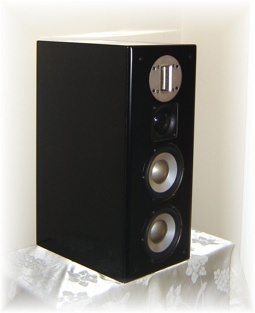

Custom design with a matching center channel coming soon to the Houston area...

BAM!  Don't know how I missed it Rick?! :duh:  I been so busy at work, and you've already had pics up for over a week - man I must pay better attention or browse over here more often!  Thanks for posting the pic - they look beauteous! - can't wait to hear them.  :thumb:

I finished Trey's left and right speakers this afternoon and set them on some 18" stands for a listen. Worst bass balance I've heard in a long time. My RS sound meter revealed a 10dB peak below 100hz. Then I checked the woofer specs and realized they are four ohm drivers and are intended to be wired in series and not in parallel  :duh:
Now they're wired correctly and playing again. This time the in-room bass response is flat down to 60hz, exactly what I would expect for a sealed enclosure that's intended for use in Trey's HT system with a subwoofer or two. Then I placed a sealed subwoofer into the system. Trey, you're going to like these speakers.  :thumb:
