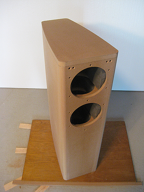

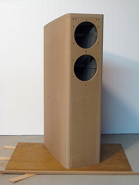

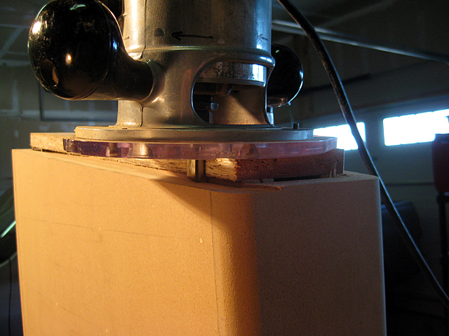

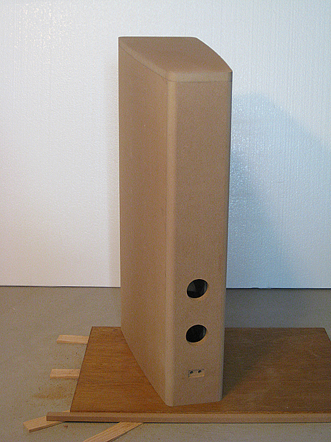

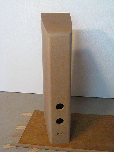

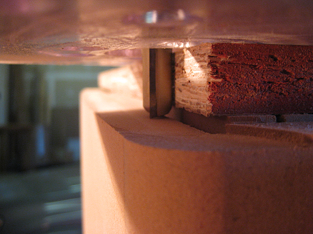

In order to apply the top piece, I had to get a nice even surface on the side angled edges. I did this with the router running along a piece of MDF temporally tacked at the correct angle. This was tricky to do because the base plate had a little bit of flex to it and I had to slightly lift the router as I made the passes to the outside edge of the edges. I then turned the box upside down and slid it over some 150 grit sandpaper glued down to my tablesaw top to get a nice even surface.
I like the look of the box on it's own. I think it has a very pleasing form.

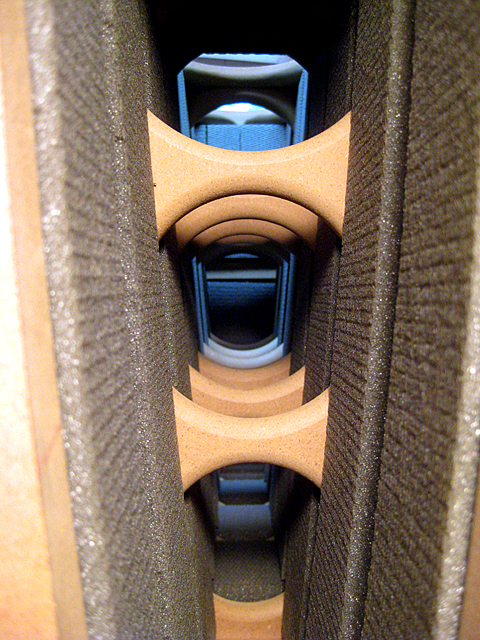

Here's a last shot of the interior and the bass box on it's own without the baffle.
I've finished the box and will now start on the veneer.

This image, I just stare at in awe:
Fantastic. Simply amazing.

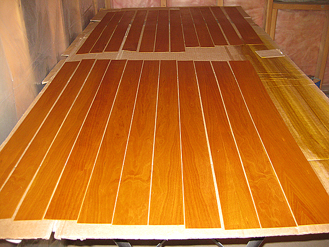

Well, finally, warmer days. I was able to start veneering the boxes.  :D

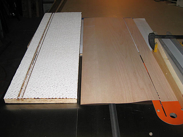

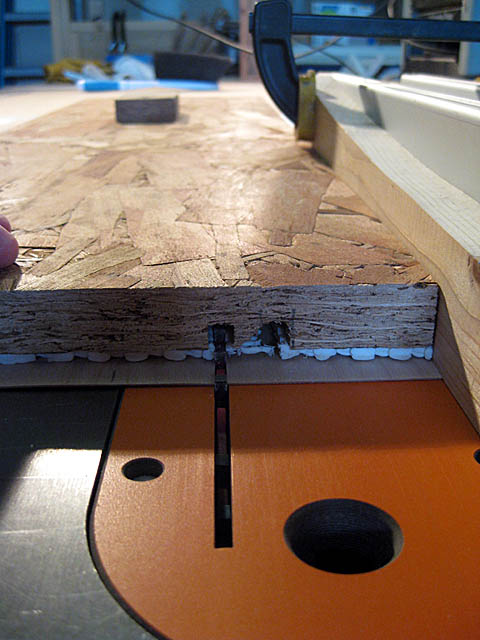

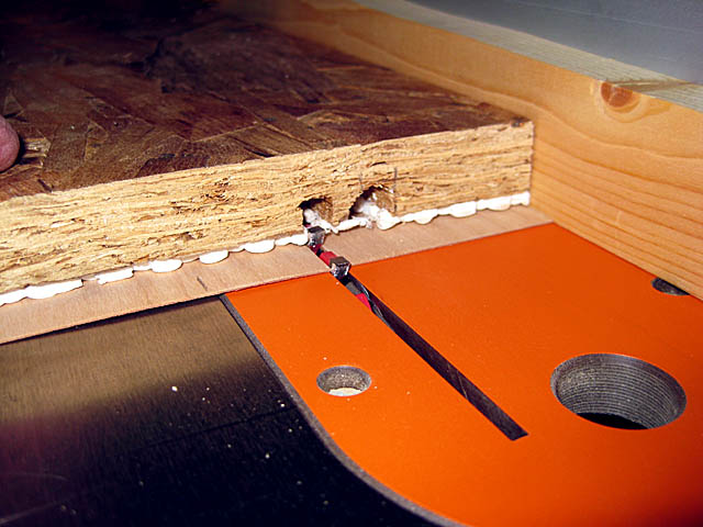

The veneer will go on as 2"-2¼" strips, so the first thing to figure out was how to cut such thin material in parallel strips. I thought about just using a straightedge and razor blade but that wasn't accurate enough.  :? The next test was to see how well it would run through a tablesaw blade. Perfect ! That was it ! So what I did was to essentially make a large GRR-Ripper that would completely cover the veneer and guide it over the saw blade. I lowered the blade and aligned the veneer and guide to the fence, slid them back, raised the blade about an ⅛" and ran it over the blade. Perfect parallel strips !
« Last Edit: 24 Apr 2009, 05:09 pm by Voncarlos »
Voncarlos
  • Posts: 156
  • OB5s in Stripes
Re: OB-5 Construction by Carlos
« Reply #93 on: 24 Apr 2009, 05:08 pm »

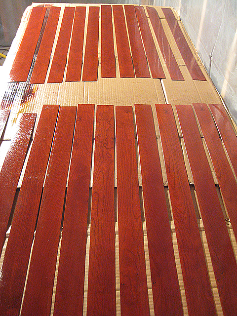

The next thing to do was to get the Cherry strips stained and first-coated before they get applied. Cherry can be problematic when it comes to stain so most folks will lay down a coat of thinned shellac first and this will ensure that the stain takes evenly and you don't end up with a blotchy look . This is what I did first, then a coat of yellow dye followed by the stain and then two topcoats of water based polyurethane. This was the same procedure that I applied to the baffles.

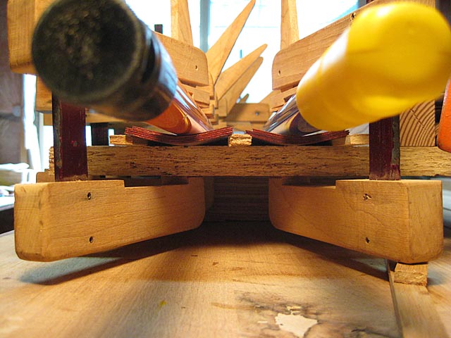

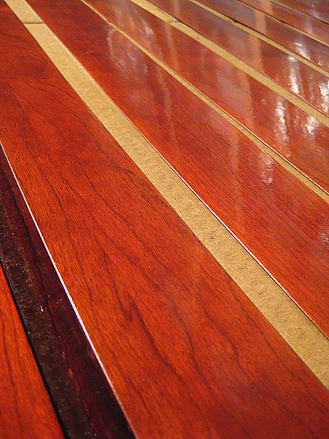

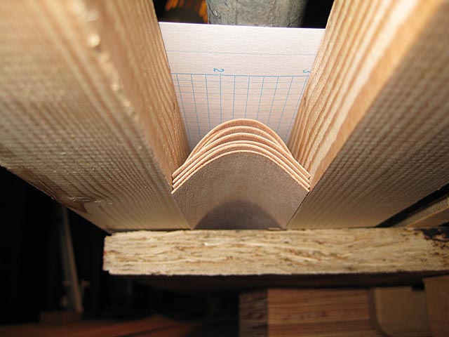

When you build something that was only an idea in your head, you're never quite sure if it's going to work out, the way you though and there's always little unknowns that pop up. Happily the veneering went smoothly.
But! When the protective clear coats dried on the Cherry strips, they wanted to slightly curl in the wrong direction, so I had to built a little form to remind them of their place.
The same with the Maple corner strips. They didn't want to make the ¾" radius without cracking, so I applied a little water to the outside face, let time slowly curl them and then placed them in a containment form. Even this was troubling, because if you use to much water, the veneer will crack as it drys. The veneer is a wood-backed veneer
