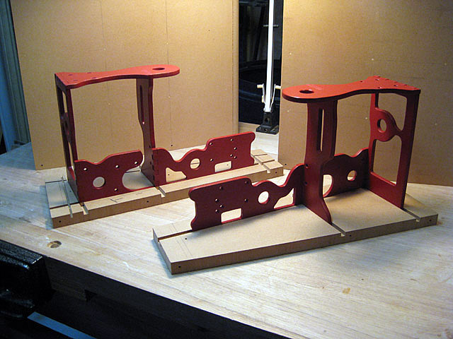

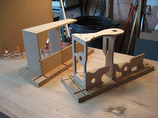

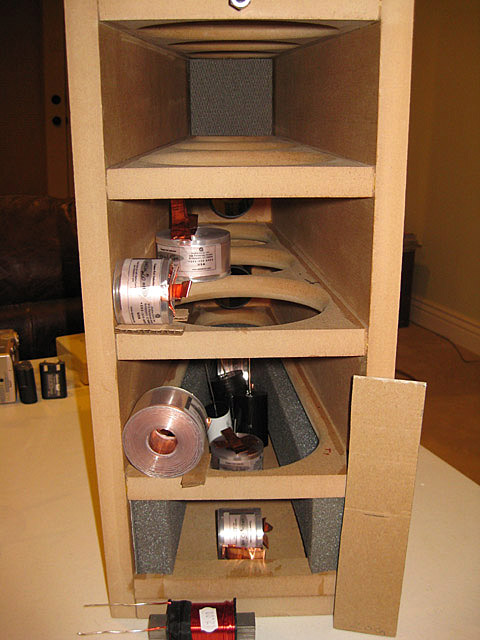

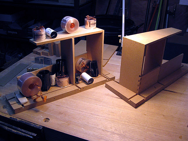

Well, I've been baffled (ha ha) a bit about how to layout the crossover components. The speaker box gets very narrow in the back and the No-Rez takes away even more space, so there isn't a whole lot of room to work with. I didn't want to mount the X-over on boards that are then mounted to the side walls, as I didn't want to lose the benefit of the No-Rez. I also found that to minimize the Inductors interfering with each other, there was very little leeway in their placement.
So, I decided to build a rack attached to the bottom piece.
This would allow me to keep the inductors away from each other, especially the large ones and give me lots of places to mount the various components.

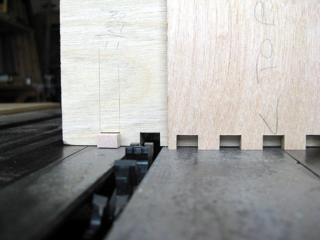

I did the finger joints with a dado blade on the table saw. Finger joints increased the glue surface area on such small edges and allowed for the slight 5 degree angle.

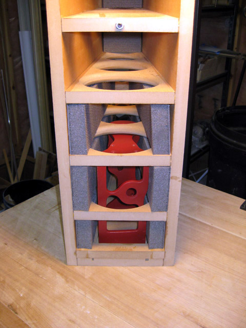

Unfortunately the rack also interferes with the volume and free flow of air, so I'll have to do some trimming.
I wanted to stain them the same as the speakers but this didn't look very good since the MDF doesn't take well to staining. So I painted them red.
Now there's a little more free flow room.

Wow, that is truly wild and creative...  Any thought to just making them external with Speakon connectors like Bill Bakers (Response Audio)?  That would solve the volume change issue.

I love how the crossover rack follows the form of the components.  It's a work of are in itself.  You must leave those crossovers external.

Quite an artful touch there, Carlos:  air flow impedance decreased, visually pleasing.  Even though hidden from view, you'll have the satisfaction of knowing the "rack" design serves its purpose.

the problem I see with is crossover stand is that it makes for great art, I would rather see it on the outside of the speaker. So, Carlos, to review:
1. covering up beautiful veneer  with speakers... bad
2. creating awesome modern sculpture and placing it  inside your speakers... even bad-er. That's like putting a fine finish on the back and bottom of your speakers, come on now.
In the recesses of my mind, I have an idea that my next speaker project will be an OB-5, with all the bracing on the outside (an exoskeleton), along with the guts (an external crossover). Your design certainly would look nice on the outside, and that would be bad-er-er.  :lol:
