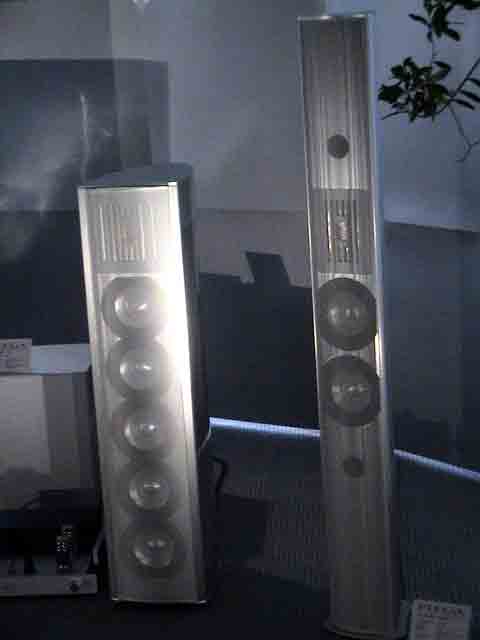

WerTicus
Re: the case against a 10 gram, 6 inch tweeter....
« Reply #64 on: 18 Sep 2008, 09:11 am »
have you looked at a raven r3?
500hz - 30khz  about as wide range as it gets.
then there is BEengineering's gear similar ranges even better designs though (same designer new company)
Their latest flagship driver is $15k or so  :P  But with DIY the savings over what any design using such a device would cost is huge! :)
http://estore.websitepros.com/1736754/Categories.bok?category=ALIAN
Anyhow the speakers i've heard using the older version of this 'driver' were easily the best i've ever heard.
It wasnt a single driver solution but rather the cylinder driver plus two focal drivers for the bass.
I believe there is a DIY version called the 'new york noise maker'
but here is a render of the WAR Audio version:

the new york noisemaker was a zalytron kit that used the raven f3 crossed over to two peerless 10" woofers at 800hz.
the alian tweet referenced that goes for $15k each looks like a coax driver.  i like the coax ribbon driver used in the top line piegas - they cross over to mid-woofers at ~550hz...  coax x-over is at 3.5khz.  i have a pair of p5 ltd mkll's that have this driver.  quite nice.   8)  (an unfortunate turn in personal fortunes mean i may have to put these up f/s soon.   :? )

For instance when I see the LF LS in the thumb above provided by WerTicus - internally I go yeough !  I'm so off avoidable monopolar room/building pressurisation (boom-boom) now !
