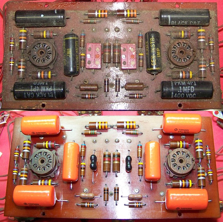

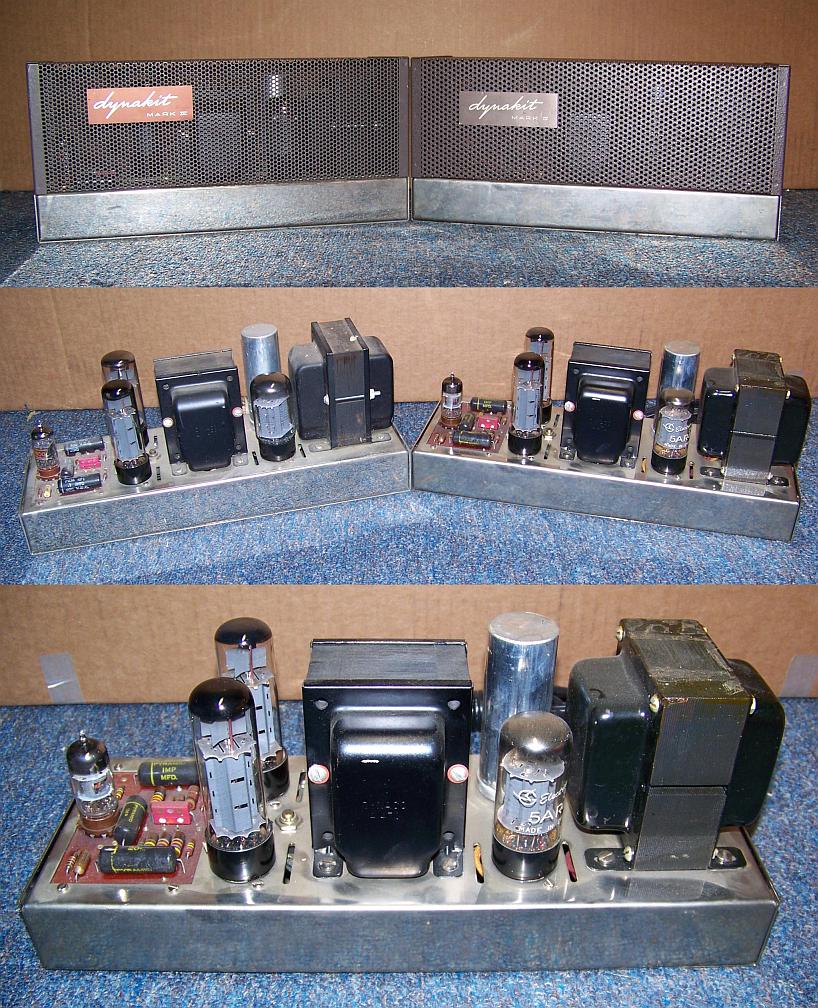

Just a little intro, my name is Sal Brisindi, I am into tube audio, tube radios and when time permits, R/C airplanes. I have been collecting and restoring tube radios for the last 12 years now owning over 200 radios, not to mention 6 Dynaco ST-70's, 2 Dynaco Mark IV's, PAS-3 etc... I have been restoring/rebuilding Dynaco ST-70's of late and below is a before and after photo of one I completed about 6 weeks ago (I actually did 2 of them at the same time). If you wonder how I got the chassis so shiny, its because I purchased a new stainless steel chassis from Dynakitparts.com.
I took photos along the way of the restoration, sooner or later I will write a restoration article. This amp was in very poor condition, some wiring modifications, broken switches, etc. I took apart the transformers, sanded them, gave them 2 coats of primer and 2 coats of semi-gloss black paint. Cleaned the printed circuit board, replaced every capacitor, a few resistors, replaced the selenium rectifier with a 1N4007 diode, new RCA jacks and new speaker terminals in the back.
Note: I didn't go as deep as Bill Thomas did removing all the components off the circuit board, I even used the same tube sockets. I did leave the 10k bias resistor and tried a few different brands of EL34's and the bias was able to be set with no problems, including a quad of "real" Mullard EL34's.

AN EXCELLENT job, Sal. I take it you used one of Kevin's new chassis' from Dynakit Parts, right? (Believe me, I KNOW how much time *that* saves! It takes several DAYS of polishing to get one of the stock chassis' back into presentable condition. (And the "before" picture you posted showed a chassis that was WAY too far gone to save.)
Well Done!

Yes, I will be restoring 2 more ST-70 in the near future and 2 PAS-3 preamps. Out of my 6 ST-70's, 4 of them are electrically restored, the two I completely restored with new chassis was for someone else. If anyone is interested, I took photos along the way pretty much step by step and I can post the photos here. Below is a before and after of the printed circuit board.

I'm an old "ex New Yawker" myself, but decided to hang out in the Blue Ridge Mountains for a while. I have pretty much all the parts necessary to restore the existing amps, although there are a few that will require a chassis. The saddest case is a factory-wired chassis. It is totally beyond reclaiming. Still, it is unmolested and helped to show how Dynaco did it back "in the day." (As I'm sure you know, there are a few minor differences.)
Your Driver Board "before" picture is pretty typical of what I find. Getting that "crud" off the board is pretty troublesome, but essential. Nice work!
