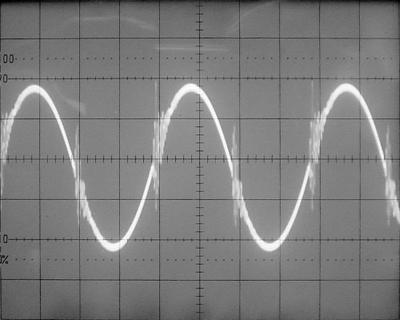

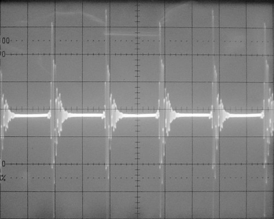

I am amazed no one has published scope photos of a typical switching amp output waveform, with its multiple oscillations, noise and HF parasites. Many audiophiles would be shocked.
Image 1: Amplifier A, Differential Mode. 500us/div, 200mV/div.
Image 2: Amplifier A, Common Mode. 500us/div, 1V/div.

Please note that the article was written by Bruno Putzeys, developer of the Hypex switching modules. Not all switching amps are created, or rather, implemented equally.
