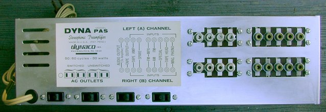

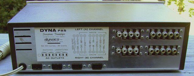

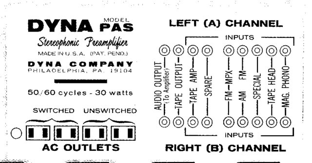

Cleanup is not as simple as it sounds. After performing a high-resolution scan of the rear panel, I spent MANY hours cleaning up the result. After a particularly grueling session of making the blacks blacker, and the edge transitions cleaner, I took a break and sorted and inventoried more NOS Dynaco parts. Lo and behold, I stumbled onto a few NOS labels! Here's a photo of the one we will use:
This is the later "Dynaco" branded version. Since this is the version used on the last production run of original PAS-3X preamplifiers, it seems more fitting to use this version on our "Final" PAS-3X preamplifier and it'll save untold hours of cleanup on our prior high-resolution scanned label. (And some people say there is no God! I have PROOF otherwise!) Here's a picture of the Rear Panel of our PAS-3X preamplifier with the NOS label attached:

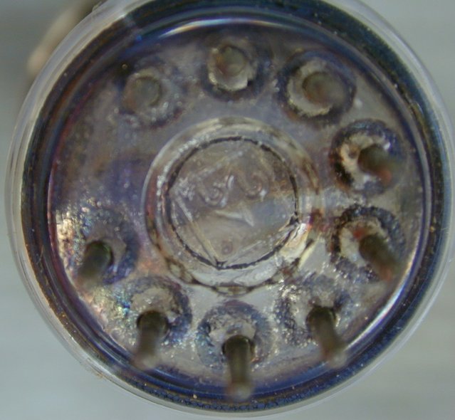

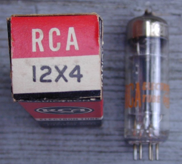

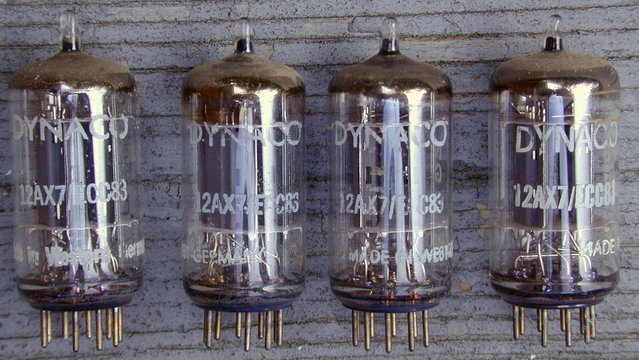

OK, that's ONE "finishing touch", but now it's on to something MUCH more important, namely: tubes! Since this is a very "special" project, we need some really *special* 12AX7's to populate the finished preamplifier. I think it's safe to say that there is probably no more "special" 12AX7 than those made by Telefunken. Dynaco thought so too!
These are original Dynaco-branded, Telefunken-manufactured 12AX7's. For proof, just look on the bottom of the tube and you'll see the Telefunken "diamond" cast into the glass. Here's what to look for:
No, these are not brand new or NOS. These were "reclaimed" from existing PAS preamplifiers. Since a "stock" PAS preamplifier runs these tubes at well UNDER their rated filament Voltage, these tubes last nearly as long as rocks. BUT, (isn't there ALWAYS a "but?") there is a "dirty little secret" concerning Telefunken tubes. They tend to be *slightly* microphonic. When you tap on the glass of most Telefunken 12AX7's with a pencil eraser, you'll hear a rather musical "dong" produced. Usually, it isn't too pronounced, but *occasionally* it can be serious enough that high sound pressure levels can cause mechanical "ringing" in the audio. These tubes have been carefully selected from my "reclaimed" Telefunken's for lowest microphonics, balanced with strongest performance. A preamplifier this nice simply deserves the BEST! I've also added a NOS RCA 12X4 rectifier

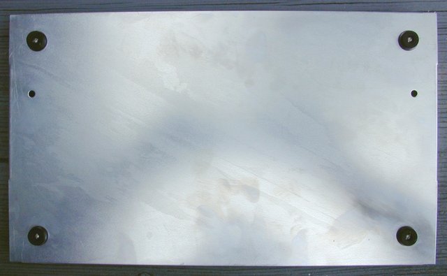

So what's left? Well, our final items are both cosmetic AND *crucial* to provide the lowest noise, as well as the most reliable operation of our PAS-3X preamplifier, namely: the top cover and the bottom panel. Here's a picture of our re-plated bottom panel with the rubber feet installed:

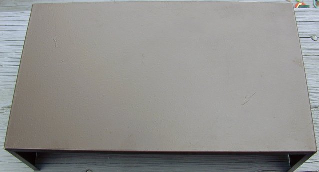

But the top cover is also vitally important.
Note: this Top Cover is not cosmetically perfect. You can see a scratch on the right and some flaws in the paint elsewhere. But after 40+ years, we'll just call this a pretty good "survivor" and the best one I have available. Dynaco relied upon these metal parts to provide a completely shielded enclosure. Without them, the overall noise and hum levels increase significantly - an increase of as much as 6 dB! Even MORE in an "electrically noisy" environment. (Triac "hash" from lamp dimmers can be especially troublesome.)

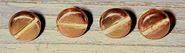

We have one LAST "finishing touch" and then we can FINALLY call this project a "wrap!" Take a look at these little beasties:
These are original Cover Screws for the PAS-3X preamplifier. (Sorry the picture is less than ideal. It was shot in the dark with a flash.) If the screws on your unit are silver, they aren't Dynaco originals. These are brass and although they were EXTREMELY oxidized to begin with, they actually cleaned up quite nicely, thanks to Wright's Brass Polish and fine steel wool. (And it only took about 45 minutes to get them looking pretty again!)

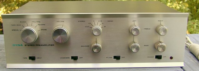

Now, at LONG last, our *final* PAS-3X is complete. Here is a picture of the front of the finished unit:
And here is a picture of the back of our finished preamplifier:
It has been quite a journey to arrive at this point. I have tried to keep the "flavor" of the original design, while applying a few *slight* changes to either improve performance, or increase the usefulness of the preamplifier with today's typical audio sources. The preamplifier exhibits improved crosstalk figures between sources, it adheres MUCH more closely with the RIAA equalization curve, and has improved bass response throughout. Cosmetically, it *just* misses an A+ rating, but I would consider it a solid "Grade A" instead. Let me know what YOU think.
