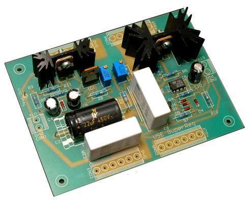

I hope he will clean this up especially since he is claiming noise numbers that are not achievable with active regulators unless you have a resistor feeding a big cap filter after them which both slows them down and degrades the output impedance.
Obviously something is amiss. I'm surprised no one else caught this type of error earlier.
Assuming these regulators were actually substantially "better" than typical PS regulation (whatever that may mean given the dubious specs) ... would this translate into a noticeable audible improvement?

Bad regulators can cause problems worse than simple R C power supply filtering. However, good regulators will give better results as they will have constant impedance over the audio band. In my studies of HV regulators in many popular preamps I was rather disappointed with their performance. In addition, most of them are not short-circuit proof which I find unforgivable.
