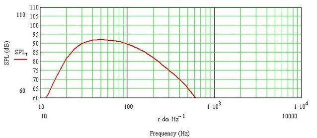

Here is how two Augies placed low on two 40" (H) x 24" (W) baffles, Augies connected in parallel, simulate, LP 65 Hz 2nd order and Rumble filter at 20 Hz 3rd order , 2.83 volt applied :
You can get all Augie data by reading carefully on the Hawthorne forum (Qes = 1.02 and Qms = 8.9). To me it seems that trying to dipole-compensate only would exaggerate the response as Augie's  already high Qts = 0.92 will create a little hump of its own in the lowest end.
/Erling
[snip]
/Erling
I wouldn't worry about Qts=0.92. If you want to go back to Bob Carver's approach, the Qts is at least 1.5 or more like 2.0. That is when you don't need compensation.  In addition, a dipole sub is different from a sealed sub. In a sealed sub, a Q=0.5 sounds very clean and in a dipole sub, a Q value of 0.5 sound too dry.

Hi Brian,
I certainly is in favour of yours and Danny's Servo Basses for OB and closed boxes. That is very interesting.
No the Qts=.92 of the Augie doesn't worry me. It has passed use with high flags, see: http://www.enjoythemusic.com/magazine/equipment/0107/diy_loudspeaker_project.htm for instance.
What I was trying to say with the simulation, is that it will essentially be ruler flat in response between 30 - 100 Hz used with gooberdude's crossover frequencies and settings on the typical Hawthorne sized baffle, thus not needing any further augmention other than level adjustment. Now this low bass is not really instrumental in our awareness of bass performance. It will be the frequencies, as Dick Olsher says, 100 - 200 Hz. Thus harmonics of low bass and fundamentals of the a bit upper bass spectrum.
I think there may be some confusion about what you call an OB-shelf setting in at 80 Hz. It would be very good if you just explained what you are doing in terms of shelving or 6 dB/octave dipole compensation.  :)
/Erling

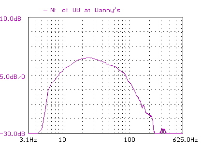

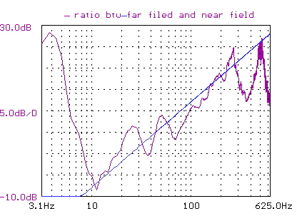

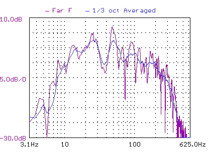

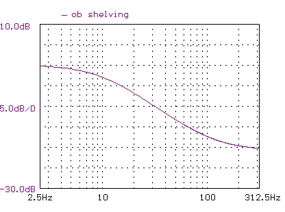

Hi Erling,
No problem. I went to Danny's place about two months ago and took some measurements on an OB sub. First is the close-mic measurement of the woofer right at the cone. Look how clean the measurement is.
This one already has a mild shelving built-in.  Next I did a far-field measurement at the  listening seating position. There are two plots: one is unsmoothed and the other is unsmoothed. The resolution of this measurement is 0.3hz. All of my measurements here are based on MLS (max length sequence). It is not a sweep. A sweep result will be questionable in a room with reflection. One can see, so-called room mode is made of a lot of smaller nodes, and the smoothed response is pretty clean above 200hz.   (BTW, keep in mind every room has room modes, even a music hall.  My Denon receiver's special effect include DSP to create room mode to mimic a music hall. I don't understand why people are obsessed with perfectly flat response at the listening position. I, on the other hand, am obsessed with how to get a flat FR at the woofer because that is how mics pick up sounds. Speakers are used to reproduce what mics pick up. And mics are not placed at listening positions.  But that is another topic)
What is interesting is the plot of transfer function. A transfer function is an abstract method to describe the input/output relation of a blackbox system (Erling, this is for other members). It enable us to analyze components in the audio chain one at a time.  In this case, the transfer function we plot uses close-mic measurement as input and smoothed far-field measurement as output.  In other words, it actually tells us if we assume the output at the cone (close-mic) is perfectly linear in terms of frequency response, what would we get at the listening position. For OB, we know there should be a 6db/oct increase up to the frequency calculated based on the girth of the enclosure equating a full wavelength (for instance, 10ft at 100hz). So next I plot this transfer function (the blue line is the "ideal" 6db/oct increase)
It is pretty close. Danny's room still have a room mode at around 30hz. And there is still a room mode below 5hz. But don't be concerned by that. So our shelving circuit is an inverse of this trend to create a 6db/oct "decrease". Since I need to limit the scope of this decrease without overloading the amplifier, I have chosen the decrease is only between 10hz to 80hz, like this one:

Brian, will I be able to purchase and install the slightly different OB shelf that the Hawthorne plate amps will be equipped with?

Tony/Matt,
That 10u cap is decoupling cap for the power amplifier section. It is also the only decoupling cap in the entire amp. The preamp section is DC coupled. The shelving is installed in a gain stage at the preamp. It is pretty effective for OB with narrow baffle. The shelving is to correct the 6db/oct slope resulted from cancellation, not for a particular driver. Unless Darrel goes back to what Bob Carver had done (used a driver with Qts value of 2.0 to mimic a shelving circuit), this should be good for most drivers. I don't think Darrel will ever use a driver with such a high Qts value. I won't.
In terms of the new board for Tony, it was a mistake on my part. Yours first servo board has one cap with incorrect value (the small compensation cap should have been 220pf, reads 221).  I sweep the amplifiers before they go out and yours is the only one I didn't do.  To be safe, I sent you a new card that I swept. If you have a chance please send back the original servo board.
Matt,
In terms of your version and HA's version, the main difference is your shelving circuit is milder, only between 20hz and 60hz. If you know how to solder, I can send you a photo explaining how to do it and you can achieve a bit wider shelving slope.
